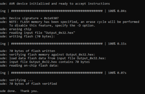

Step 3: Programming
The third step is programming. We have included a .hex file and AVRdude program in order to upload the code to microcontroller. First download the two included files then move it to a folder. Connect the microcontroller to the PC. Check which COM port the micro is connected to by opening Device Manager. Then open Command Prompt.
The link to download avrdude files are: https://drive.google.com/file/d/1pxs1oPC4CoeqdNeZ-BwSxidb2WCSw5HL/view
Type in this command:
c:\>avrdude -P COM[Change this to the correct port number] -b 19200 -c avrisp -p m2560 -u -U flash:w:”clock.hex”:i
Then you should see that the program has been updated successfully and all the functions should work accordingly.

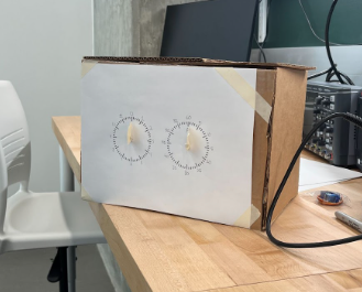

Step 4: Building the Frame

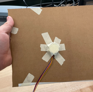

The fourth step is taking your working stepper motors and adding to the cardboard to have an almost complete project. The first thing is printing off the clock faces with the provide link in the supplies. Attach the clock face printout on the front facing cardboard piece and draw a dot in the center point of each clock face. Use the boxcutter carefully to cut a small enough hole in the center of the clock faces for the stepper motors to go through. Secure the motor with tape to hold them in the newly created holes. Next take the wall pieces of cardboard and take three pieces of tape in a L-bracket formation to hold the corners of the walls together to the clock face. Then tape the back wall in the same way the walls were taped. Lastly add the bottom piece and top piece of card board with tape with the bell on top with the motor that hits the bell when desired.
