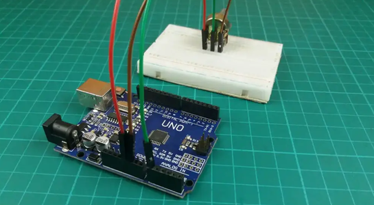

Step 2: Connect the Potentiometer
Place the potentiometer onto the breadboard.

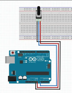

Step 3: Wire the Circuit
  1. Connect the middle pin of the potentiometer to A0 (analog pin 0) on the Arduino board.
  2. Attach one of the outer pins of the potentiometer to VCC (5V).
  3. The other outer pin should go to GND.
