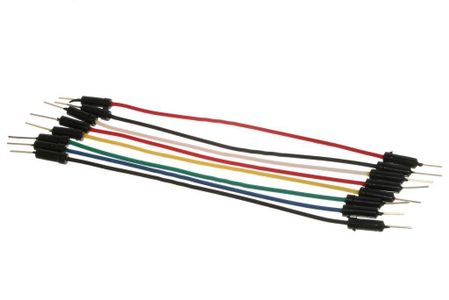

  • Jumper wires

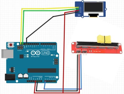

Step 2: The Circuit
  • Connect potentiometer pin [DTB] to arduino analog pin [A0]
  • Connect potentiometer pin [VCC] to arduino pin [5V]
  • Connect potentiometer pin [GND] to arduino pin [GND]
  • Connect OLED display pin [VCC] to arduino pin [5V]
  • Connect OLED display pin [GND] to arduino pin [GND]
  • Connect OLED display pin [SDA] to arduino pin [SDA]
  • Connect OLED display pin [SCL] to arduino pin [SCL]

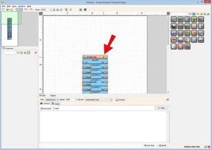

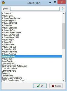

Start Visuino as shown in the first picture Click on the "Tools" button on the Arduino component (Picture 1) in Visuino When the dialog appears, select "Arduino UNO" as shown on Picture 2

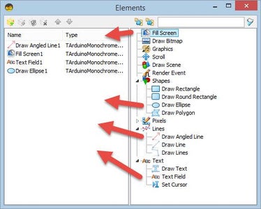

  • Add "OLED display" component
  1. Double click on the DisplayOLED1 and in the Elements window:
  2. drag "Draw Angled Line" to the left side and in the properties window set Angle to -10, End to 60, X to 64, Y to 63, select angle and click on the pin icon and select Float Sink pin
  3. drag "Fill Screen" to the left side

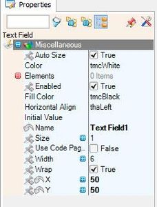

  4. drag "Text Field" to the left side and in the properties window set X to 50 and Y to 50 drag "Draw Ellipse" to the left side and in the properties window set Height to 124, Width to 124 and Y to 20
  5. Close the Elements window
