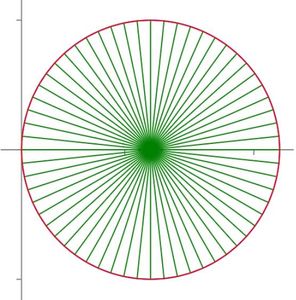

Step 1: The Minutes Functionality
You may ask, why minutes first?
It's simple, because, minutes make hour!
Grab a 360deg servo (I prefer a 360deg servo here)
Now, we need a little calculation. We know that 60 minutes => 1 hour
So,
✅ 360deg for 60 minutes
☑️ 6 deg for each minute!
We need to rotate the Servo(which will hold the clock body) 6deg after every minute. So each rotation becomes a minute. 60 of them will end up in 360deg and then we need to put it back to 0deg once again.
Set the Motor Driver shield on Arduino. Now connect the servo to Servo 1 pins.
I used the following template for the clock body. It is divided into 60 parts. Each line indicates a minute.

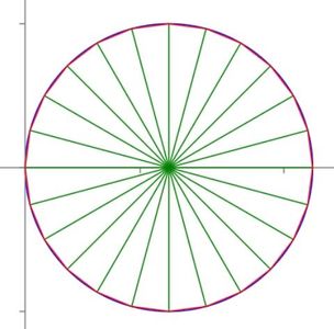

Step 2: The Hours Functionality
When we will look at the code, you will see, after the minute servo has completed all 60 steps, it comes back to the initial position and the Hour servo moves by 1 step!
In this case, I didn't have a 360deg servo unfortunately, so I had to use a 180deg servo. This made me to make a 12 hour format clock.
After it reaches 12, the servo will rotate to the initial position in the next step.
Check my template below. I cut it half because there are 24 parts here. If you have a 360deg servo, you will want to use the full thing.
Just like before, if you calculate, this time it needs to rotate 15deg for each step.
Connect the servo with Servo 2 pins of the motor driver.
