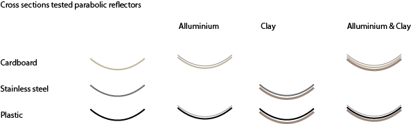

To find out what is the most effective parabolic speaker, which can be easily prototyped, we performed some tests with reflectors made out of different materials: cardboard, plastic and stainless steel. We tested them with a layer of aluminum inside and/or clay on the outside and without any layers. (See the attached document for theoretical knowledge on why to use aluminum and clay layers.)

Step 8: The Test Set-up
To test the parabolic reflectors you can make the set-up as can be seen above. The circled numbers indicate the places where to measure the sound. To make sure using a similar set up for every parabolic speaker you can use pieces of tape to mark all places where to measure the sound and to mark the place of the center of the speaker. The different set-ups as tested can be seen in the scheme below.
