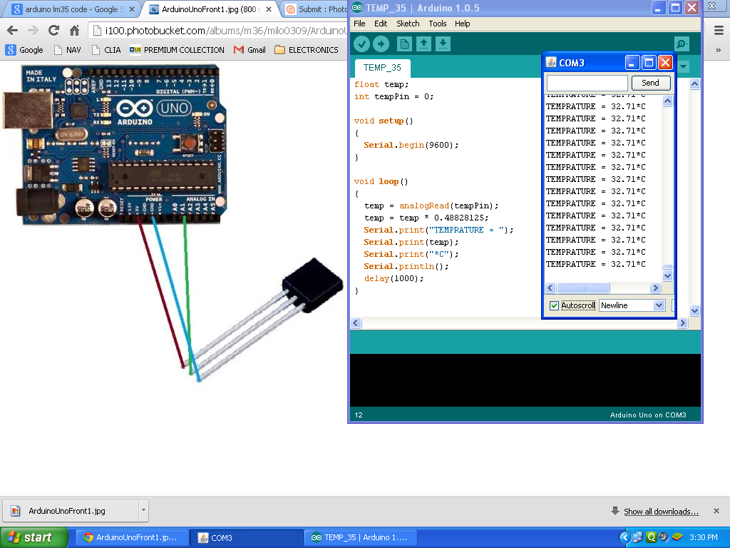

Step 3: Upload Code and the Background Board
I have the code attached with the file.Try to learn it and upload to arduino.After uploading,
Now take a cardboard and make a semi circular piece. Now take a protractor and make angles of 15degrees taking the center of the semicircle as the reference.Refer to my picture. Now mark the temperature from 0-60 degree Celsius. For Fahrenheit make your own settings. Now make a hole at the center and insert the servo's small shaft into it. Now attach the long shaft given in the pack of the servo, and then attach a small stick as dial.
Now test the whole thing in 1)living room, 2)near a fire or hot thing,3) inside your refrigerator . If it works fine you are good. If not ,check your connections again e.g. whether you connected your sensor's pin and servo data pin correctly or not. You might have to calibrate your servo as per your setup.(either only x degrees or 180-x degrees)
