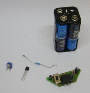

1 x LM35C or LM35D Precision Centigrade Temperature Sensor TO-92 package.
1 x Battery holder (4 cell)
1 x Battery connector
4 x 1.5 volt "AA" Batteries.
1 x 2 pole change-over switch
1 x 6K8 ohm Resistor
1 x 1K ohm linear variable Resistor (TrimPot)
1 x circuit board

In a convenient box/enclosure mount the switch and battery holder.
Connect the Meter terminals to the change-over switch common contacts.
Connect the Battery Negative to both switch terminals that are switched to the negative pole of the Meter.
Connect one end of the Variable resistor to one switch terminal on the positive pole of the Meter and the fixed Resistor to the other switch terminal.
Connect the Variable resistor Wiper connection to the spare Variable resistor terminal (prevents open-circuit over-run) and then connect to the LM35 Output pin2 (middle).
Connect the negative battery connector wire to the switch Negative and to the LM35 GND pin3
Connect the positive battery connector wire to the Meter series resistor and to the LM35 +Vs pin1
The addition of a 2 way change-over switch and a 6K8 ohm Resistor the battery voltage can be checked.
Connect one end of the 6K8 ohm Resistor to positive battery connector wire and the other end to the change-over switch terminal.
