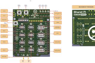

Step 1: ABOUT BHARAT PI SENSOR DOCK
The Bharat Pi Sensor Dock is a versatile development platform designed to simplify the integration of multiple sensors with microcontrollers or single-board computers like the Raspberry Pi. It is tailored for educational, prototyping, and IoT applications, offering a modular and user-friendly interface to explore various sensor technologies.

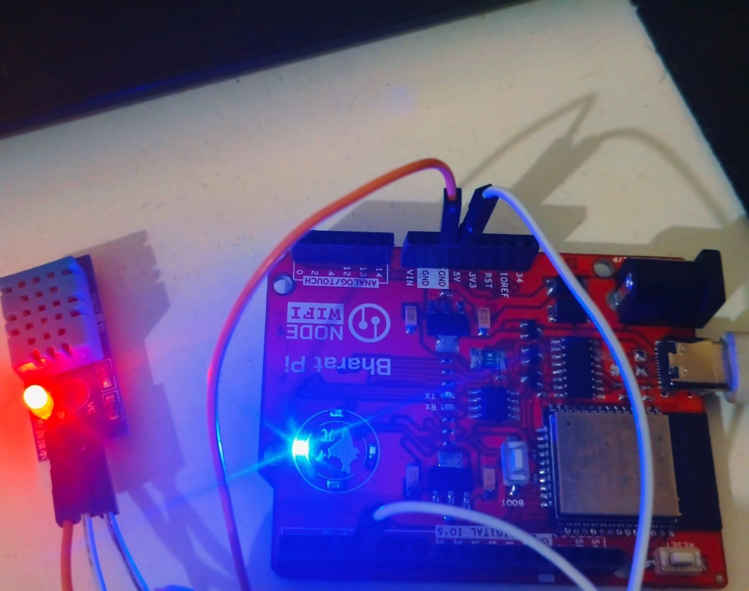

Step 2: Connection
make sure u have short pwr and sw
Central Sensor Dock/Shield
  1. The shield has labeled ports (e.g., D2, D3, etc.) corresponding to digital or analog pins.
  2. Each port provides power (VCC), ground (GND), and signal pins (S).
  3. The sensors are connected using jumper wires to these ports for easy interfacing.
MAGNETIC FIELD SENSOR(Top Left)
  1. A MAGNETIC FIELD SENSOR is connected.
  2. Wiring:
  3. VCC (Red): Powers the sensor.
  4. GND (Black): Ground connection.
  5. Signal (Yellow): Output connected to the shield for detecting gas presence.
  6. Analog Pin Not Used: The analog output pin is not connected, implying digital output is being used.

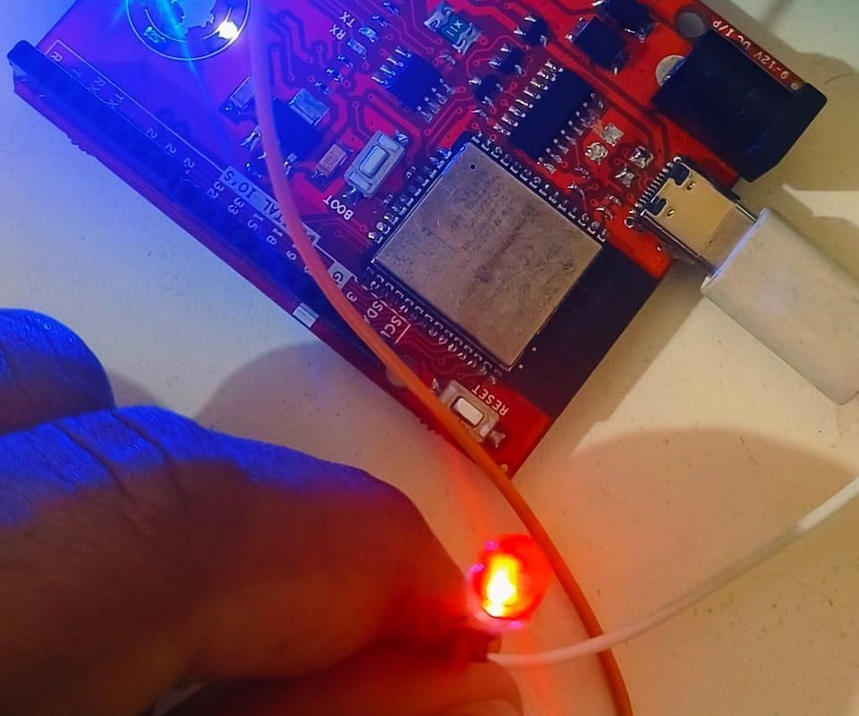

Flame Sensor (Bottom Left)
  1. A Flame sensor module is connected to detect fire or flame light.
  2. Wiring:
  3. VCC (Red): Supplies power.
  5. Signal (Yellow): Connected to the shield for detecting flame presence.
  6. Analog Pin Not Used: The analog pin is not connected, so digital output is utilized.
DHT11 Temperature and Humidity Sensor (Bottom Center)
  1. The DHT11 sensor measures temperature and humidity.
  2. Wiring:
  5. Signal (Yellow): Digital data pin for sending temperature and humidity readings.
Ultrasonic Sensor (Top Right)
  1. The HC-SR04 Ultrasonic sensor measures distance using sound waves.
  2. Wiring:
  5. TRIG (Green): Trigger pin connected to the shield.
  6. ECHO (Yellow): Echo pin connected to the shield
LDR(Bottom Right)
  1. The LDR module detects LIGHT INTENSITY
  2. Wiring:
  5. Signal (Yellow): Sends light intensity detection signals to the shiel
