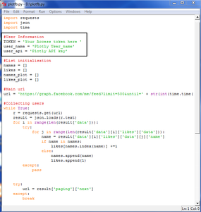

Attached is the python code of our app. Download it.
Open 'Python(IDLE)' from Start menu. Open the code you just downloaded. It will look as shown in screenshot attached.
Lets analyze the code.
We just need to input values under 'User Information block' and rest code is just fine.
What the code does?
The code will iterate through each of your wall post and keep a track of friends who liked your wallpost. It will collect all 'likes' and generate information about which friend has given most number of likes.
