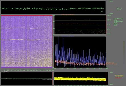

Step 5: Results.
The laptop screen will show us a set of six boxes, as we see in the initial figure. The first one shows us the captured signal as the values ​​are read in the USB port up to a maximum of 1024 values, that is, a frame.
Then, going down to the left, we have the presentation of the Fourier spectrum of this signal in the format known as “cascade”, in which the relative intensity of each frequency component is encoded according to an arbitrary color scale. This chromatic scale is shown as a line on the far right. This window is very interesting, as it gives us a global and historical view of what was measured.
Below this window is another one that shows us in white the RMS value of the signal for each frame of 1024 values. Similarly, the lower right window shows the signal excursion in each frame, in yellow, i.e. minimum and maximum, as well as the respective average value in red.
Also on the right side, two other windows can be seen: the lower one shows the spectrum of the last frame in blue and the filtered spectrum according to the exponential moving average (EMA) for all the frames already read is superimposed. This filtered spectrum is shown in orange. The units are arbitrary since they depend on the units used in the sensor. The coefficient that governs the EMA filter can be modified in the line:
21 float a=0.2;
The smaller the value of this parameter, the less importance the last measurement has with respect to the previous accumulated history. In this way, the noises tend to remain at a constant and low level but the frequency of a present signal becomes more prominent as more frames are examined. This EMA filter is of the low-pass type so it also helps to dampen aliasing frequencies. There is also an interesting article on EMA filters on Wikipedia.
On the upper right side there is a window that informs us about the value of the maximum frequency found in each sample, in orange.

In the example we presented, we focused on examining the vertical component of the magnetic field in my environment. To do this, in the ESP8266 program, only the following expression was used in line 126:
126 Serial.print(raw.ZAxis);
By changing this section of the program, it is possible to analyze different components of the field or the field as a whole.
The installation we used is in an apartment building in the middle of Santiago, a few hundred meters from the subway and on an intermediate floor, so it is a very adverse environment. However, the results are interesting as we observed a frequency around seven and eight Hertz. We do not dare to claim that this is the Schumann resonance, but we like to believe that it is, although further analysis of more examples and testing in other environments will be necessary.
We currently do not have an explanation for the presence of these frequencies as they could be of human or natural origin. This is part of the charm of low-frequency signal analysis, and any determined explanation will be very welcome.
