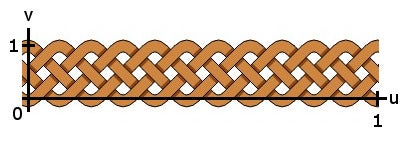

Now we need to take the knot grid and turn it into 3D curves. Let's start by assigning a local coordinate space for our knot grid.
So now we have a (u,v) coordinate for every point in our grid. Keep in mind that the knot wraps around, so a u of 0 will be the same as a u of 1.

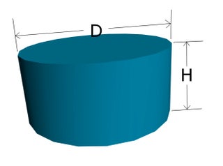

Now, let's define a cylinder with diameter D and height H:
If we set the z-axis to the main axis of the cylinder and put the origin in the center of the cylinder, we can map our (u,v) coordinates to a 3D point with the following equations:
x = D/2*cos(360*u)
y = D/2*sin(360*u)
z = -H/2*(1-v)+H/2*v

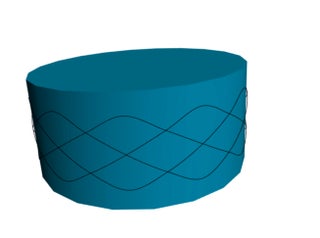

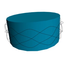

Now we walk through our grid, like we did in the first step and drop a 3D point at each grid point using the above equations. We can then connect the points as a curve using Catmull-Rom interpolation. Note that in the image below H was set to a smaller value than the actual height of the cylinder, which is why the curve doesn't go all the way to the top and bottom.
Now we need to offset the points to account for when we give thickness to the curve as well as the overs and unders. We need to offset the points outward from the cylinder at each grid point. To calculate the direction we need to offset we use equations very similar to above, except z will always be 0 and D is irrelevent as we want a unit length vector:
Nx = cos(360*u);
Ny = sin(360*u);
Nz = 0;
After offsetting the curve we get the following:

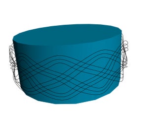

After weaving a Turk's knot, the knot is often followed around again to create extra passes. Three passes usually gives a nice look. To do that we'll add 2 more parallel curves.

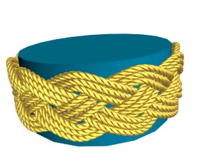

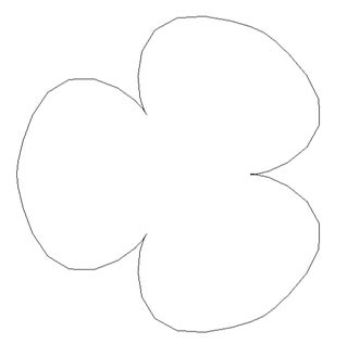

Now it's time to take those curves and give them thickness. We'll extrude a 2D shape along the curve to get various looks. For starters, we'll extrude a circle to create tubes.
We can get fancier and extrude a shape like this while at the same time twisting it to make it look like rope:
