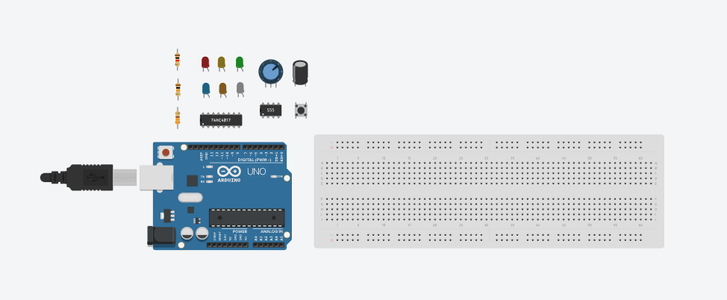

Step 1: Setup
Begin by bringing in all of our LED Chaser components. This stage is really important since it makes the process and steps much easier to follow. This is also beneficial because everything is arranged, and you won't have to seek for parts after this stage is completed.

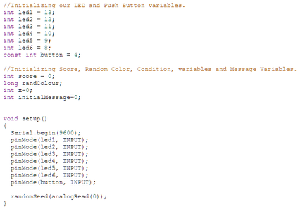

Step 5: Code

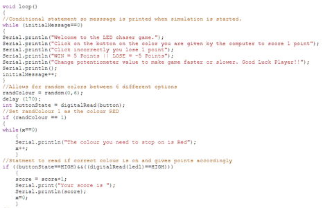

This is the TinkerCad code for the LED Chaser game. It simply checks for push button inputs to determine a winning or losing conditions. The code checks for the press of the button for the random colour given to us by the computer is turned on.
To start playing, make sure you start simulation --> open "Serial Monitor" --> check the colour given to you by the computer --> score as many points as you can!!
Throughout this code, there is a good amount of usage of the comments "//" as these are used to aid my thought process and justification for the code and why it was used.
