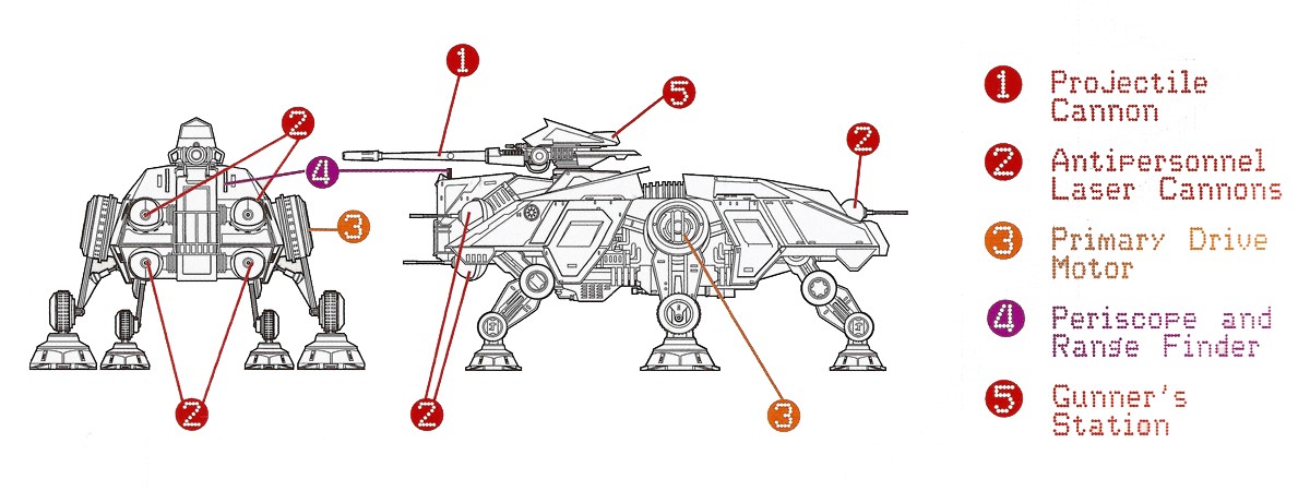

Step 2: Schematics and Images
The main schematics I used for the build was from vignette2.wikia.nocookie.net. I superimposed my original Millennium Falcon and AT-ST schematics to get an approximate scale for the AT-TE. Google images keywords was "AT-TE". Below are the URL's of images and schematics I referenced for this project:
http://vignette2.wikia.nocookie.net/starwars/image...
http://vignette4.wikia.nocookie.net/starwars/image...
http://imperialassault.com/rote/files/PR/atte_new...
I've also added a .pdf file of the plans I used in this project. No words can express my appreciation to the folks providing those amazing images. More power to everyone!
