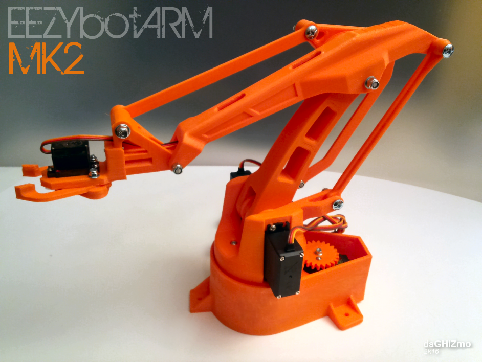

This instructables is made to explain how to control one of my EEZYbotARM or EEZYbotDELTA using a Smartphone (or a tablet). This is made via Arduino board equipped with a bluetooth module, and an Android app made with MIT App inventor 2.
video:
In the video I use it to control my EEZYbotDELTA that is a 3Dprinted parallel robot and can be downloaded for free from my Thingiverse account here http://www.thingiverse.com/thing:1249297 . Also my previous EEZYbotARM can be driven with. I made an instructables here http://www.thingiverse.com/thing:1249297 and can be dowloaded for free here http://www.thingiverse.com/thing:1249297
