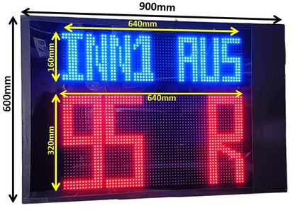

This tutorial shows how to build a large size 640mmx480mm scoreboard. This is just one example, there are more than 30 possibilities. Depending on the size, you can purchase the display modules and accessories to build other types of scoreboards as well.
This tutorial is for six displays dual color soccer, and cricket scoreboard. There are more than 30 possibilities, this is just one of them.

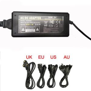

  7. 1 x 5V 4A power supply- For titles display
  8. 1 x 5V 6A power supply- For timer and Score

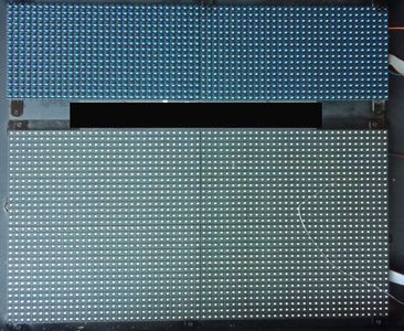

You will see arrows at the back of the display: 1 or 2 pointing upward and 1 or 2 pointing to your right. Place the display on your table exactly as shown in the image.

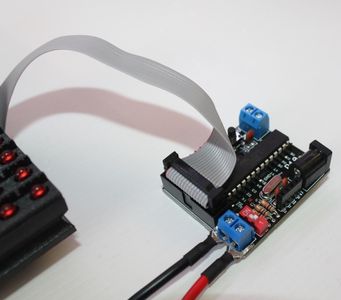

  1. Use the 16-pin IDC cables to connect the displays and use one cable to connect to the SCOREDUINO-DMD module

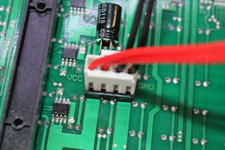

  2. Connect the power cable to the VCC and GND terminals on the display board. The RED wire goes to the VCC pin, and the BLACK wire goes to the GND pin.

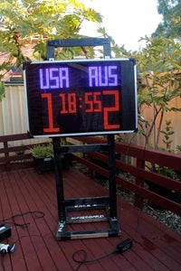

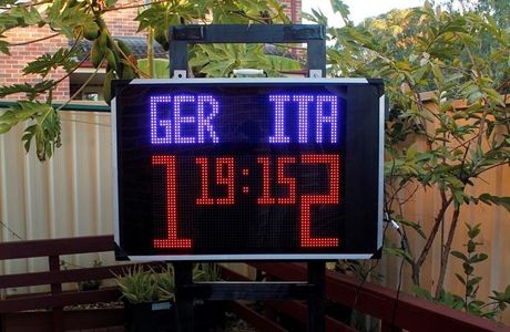

For soccer, the top 2 displays are used for team titles and bottom 4 displays are used for timer and score. In case of cricket, use the top 2 for displaying First or Second inning and the bottom 4 for displaying runs, overs and wickets.

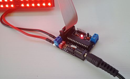

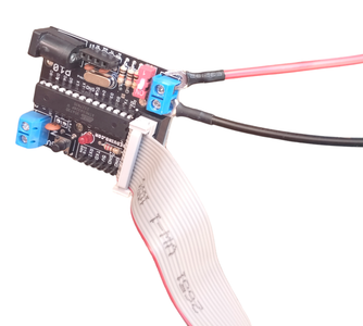

  • Use a screwdriver to connect the power cable to the screw terminal of the SCOREDUINO-DMD module.
  • Plug the 16x2 IDC cable into the IDC socket on the SCOREDUINO-DMD board.

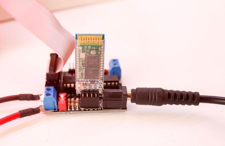

  • Attach the HC-06 Bluetooth module to the SCOREDUINO-DMD module.

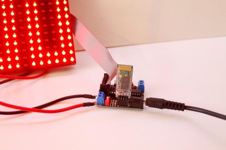

Step 3: Power Up the Scoreboard Display and Scoreduino-DMD Using 5V-6A Power Adapter
After the IDC cable and power cable are connected, you can power up the SCOREDUINO-DMD module. You will see the output that you have selected while ordering the module. In this case, you will either see output for soccer or cricket.
