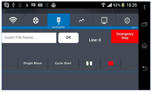

1. Read the G code from SD Card or other media freely without relying on a PC For Sending G Code.
2. CNC control without using a PC.
3. Probe Function And Auto Zero Z . (For 1.2 Beta Version)

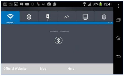

2.Bluetooth Module (HC05 Or HC06)
Install Instruction
1.Download GRBL Firmware V 0.9 Follow link http://github.com/grbl/grbl
2.Upload GRBL Firmware With Arduino IDE Download link www.arduino.cc
3.Before Upload Firmware to Arduino Must Be Correct Following : line 37 File config.h change #defineBAUD_RATE115200 to #defineBAUD_RATE9600 For use Default Bluetooth Module
4. Upload Grbl Firmware to Arduino board Please see Instruction in arduino Website
5.Test Communication with Serial Monitor In Arduino IDE Follow GRBL Website
6.Download Android G code Sender For GRBL Playstore For Install Controller
