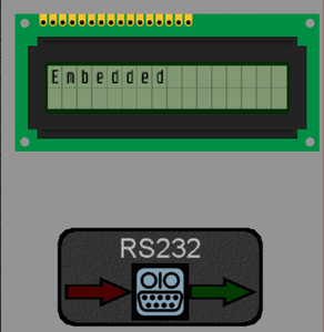

This instructable allows you to control a virtual LCD screen that is simulated using FlowCode7 by means of your Android device. You can obviously throw in other platforms but they need to be Bluetooth enabled. We will also use Arduino as an interface to PIC 16F877A (simulation in Flowcode7) and Bluetooth Module (HC-05) for receiving signals from Bluetooth device which is an Android mobile in this case.

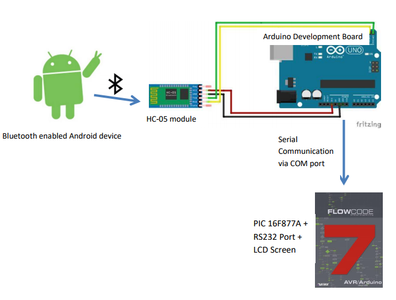

Step 2: Understanding the Plot
This illustration explains it all.

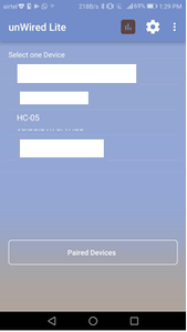

Once you are done you will find the device in the list of your Bluetooth terminal. Pair with it by selecting HC 05. The password is usually 1234.

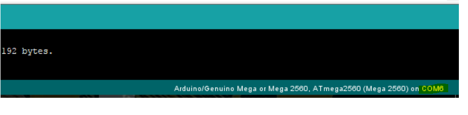

Step 5: Don't Forget to Note the COM Port!

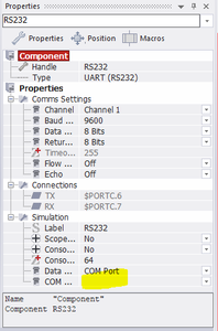

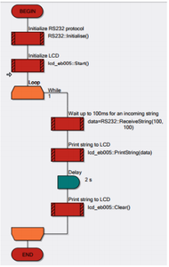

You will need to construct this Flow diagram. Drag an RS232 port and LCD to the dashboard. Connect Macros to the peripheral devices.
Select the COM port over which Arduino is connected in Properties of RS232

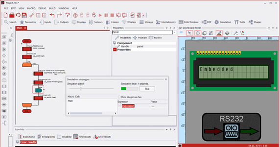

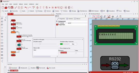

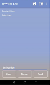

Step 7: Run the Flowcode File and Send Data From Bluetooth Device
Type in text on your bluetooth app. Make sure that the module is connected to your device. HC 05 usually blinks its LED two times with a slight delay in between when paired successfully. Make sure that the flowcode program is running before you send any data for best results. Flowcode7 ran quite slow on my PC and the outputs came up with a lot of delay.
