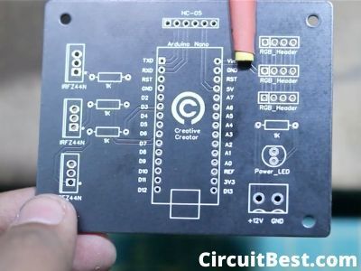

First I inspected the PCB. what's more, check whether the PCB inside the association is alright or not. In the wake of testing with a multimeter, I find that the interior association is completely useful and working consummately.
Step 2:

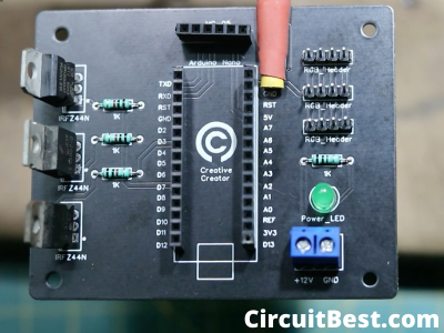

At that point I accumulated all the segments which are required for the PCB. At next I associated all the segments to its position.

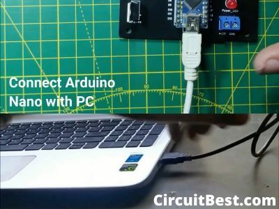

At that point, I associated the USB link with the Laptop and the Arduino nano. One thing you should take note of that here I am utilizing an Arduino nano with old BootLoader. So you should choose the old Bootloader Version.

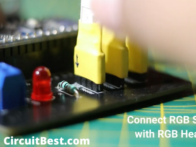

After the coding part, I have associated the 4 Pin LED wire with the circuit Male Headers. And furthermore, I have associated the Bluetooth Module with the circuit.

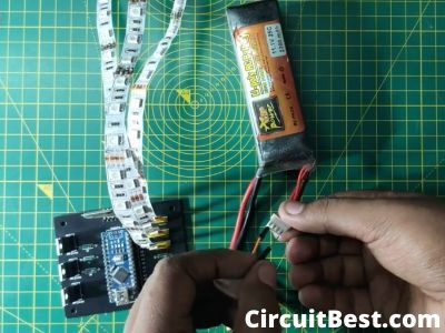

For the Power Supply, I have utilized a 3s 12v Li-Po Battery with the circuit. You can likewise utilize any 12V Power supply in the circuit.

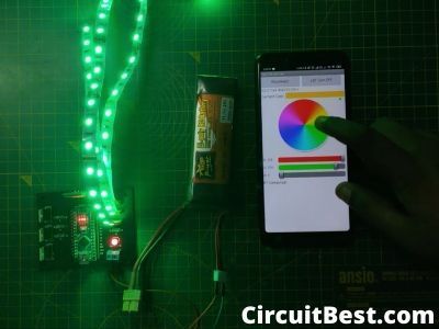

Presently I opened my Bluetooth and looked for the HC-05 Bluetooth Module. By and large, the secret phrase for the Bluetooth module is 0000 or 1234. I have downloaded the application from Play Store. Chosen the privilege Bluetooth button and associated it. What's more, Here you can see the LED shading is changing with my finger swipe. So now RGB LED Strip utilizing Arduino controlled is working.

You will require an Arduino for Providing the PWM heartbeats to the LED. These PWM Pulses are not sufficient for running the LED Strips. At next, we will require some Power Transistors for running the LED strips.
For the Power Transistor Selection, I have gone with IRFZ44N N-Channel Mosfet. Utilize The Mosfet can Drive 3 or 4 LED Strips effortlessly.
In the LED strip There are 3 Individual LEDs there are Red, Green, and Blue. I will utilize 3 Mosfets for this Project. Each LED is Connected with Each Mosfet.
We should Take Mosfet a, b, c. an is for Red. b is for Green and c is for Blue. Presently Suppose we need to illuminate the Red LED from the LED Strip. In this way, what we have to do is to Give the PWM Pulses to the Gate pin Of Mosfet a. Comparative cases will have Appeared for the Other Colors.
