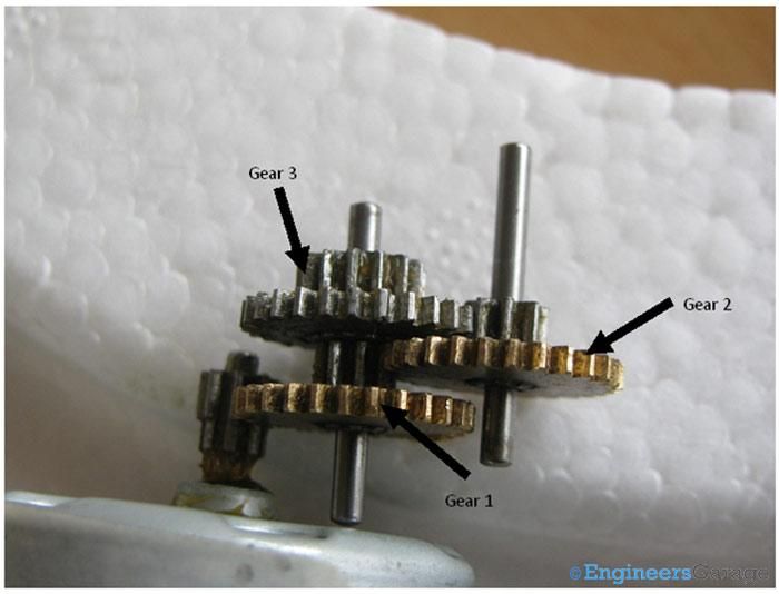

Why DC Geared Motor?
The speed of motor is counted in terms of rotations of the shaft per minute and is termed as RPM. Another important parameter of a motor is torque. Torque is a force for which rotor or shaft rotates. The more the torque, the shaft can rotate with more load. Generally a DC motor run with a high speed and low torque which is not perfect for robotics applications. Most robots required high torque with a low speed. The gear assembly helps in increasing the torque and reducing the speed. Using the correct combination of gears in a gear motor, its speed can be reduced to any desirable figure. This concept where gears reduce the speed of the vehicle but increase its torque is known as gear reduction.
To know more about motor please see my instructables: Complete Motor guide for Robotics

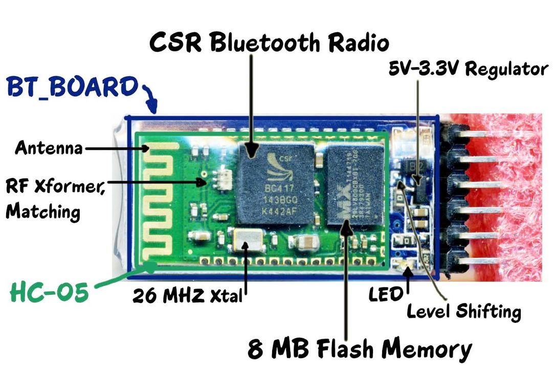

HC-05 Bluetooth Module
Bluetooth is a wireless technology standard for exchanging data over short distances (using short-wavelength UHF radio waves in the ISM band from 2.4 to 2.485 GHz) from fixed and mobile devices, and building personal area networks (PANs). Range is approximately 10 Meters (30 feet).
The HC-05 Bluetooth modules are based on the Cambridge Silicon Radio BC417 2.4 GHz BlueTooth Radio chip. This is a complex chip which uses an external 8 Mbit flash memory (datasheet). These low-cost Bluetooth Sub-modules work well with Arduino and other Microcontroller as Master or Slave. The module has two modes of operation, Command Mode where we can send AT commands to it and Data Mode where it transmits and receives data to another bluetooth module.
The module has two modes of operation, Command Mode where we can send AT commands to it and Data Mode where it transmits and receives data to another bluetooth module.The default mode is DATA Mode, and this is the default configuration, that may work fine for many applications:
Baud Rate: 9600 bps,
Data : 8 bits, Stop Bits: 1 bit, Parity : None, Handshake: None
Passkey: 1234
Device Name: HC-05
To know more details about HC-05 module visit: arduino-info.wikispaces.com

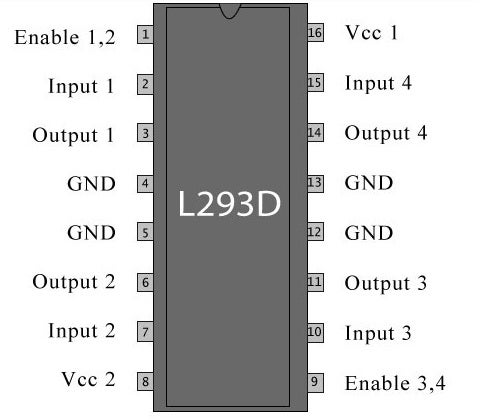

L293D Motor Driver IC
L293D is a 16-pin IC which can control a set of two DC motors simultaneously in any direction. It means that you can control two DC motor with a single L293D IC. The l293d can drive small and quiet big motors as well. There are two Enable pins on l293d. Pin 1 and pin 9, for being able to drive the motor, the pin 1 and 9 need to be high. For driving the motor with left H-bridge you need to enable pin 1 to high. And for right H-Bridge you need to make the pin 9 to high. If anyone of the either pin1 or pin9 goes low then the motor in the corresponding section will suspend working. It’s like a switch. Speed of a motor can be increased or decreased by continuous giving high and low signal to enable pin. Generally, we connect enable pin of IC to a PWM output pin of Arduino.
There are 4 input pins for l293d, pin 2,7 on the left and pin 15 ,10 on the right as shown on the pin diagram. Left input pins will regulate the rotation of motor connected across left side and right input for motor on the right hand side.
Logic Table
• Pin 2 = Logic 1 and Pin 7 = Logic 0 | Clockwise Direction
• Pin 2 = Logic 0 and Pin 7 = Logic 1 | Anticlockwise Direction
• Pin 2 = Logic 0 and Pin 7 = Logic 0 | Idle [No rotation] [Hi-Impedance state]
• Pin 2 = Logic 1 and Pin 7 = Logic 1 | Idle [No rotation]
Voltage Specification
Vcc1 is the voltage that it needs for its own internal operation 5v; L293D will not use this voltage for driving the motor. For driving the motors it has a separate provision to provide motor supply Vcc2 (pin 8). L293d will use this to drive the motor. It means if you want to operate a motor at 9V then you need to provide a Supply of 9V across Vcc2 Motor supply.
The maximum voltage for Vcc2 motor supply is 36V. It can supply a max current of 600mA per channel.Since it can drive motors Up to 36V hence you can drive pretty big motors with this l293d. VCC pin 16 is the voltage for its own internal Operation.

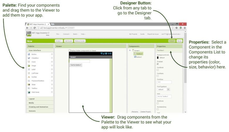

To develop app in App Inventor you have to work with two environment, the Designer and the Blocks Editor.
App Inventor Designer
The Design Window, or simply "Designer" is where you lay out the look and feel of your app, and specify what functionalities it should have. You choose things for the user interface things like Buttons, Images, and Text boxes, and functionalities like Text-to-Speech, Sensors, and GPS.
App Inventor Blocks Editor
Block Editor is used to define the app's behavior by putting blocks together.

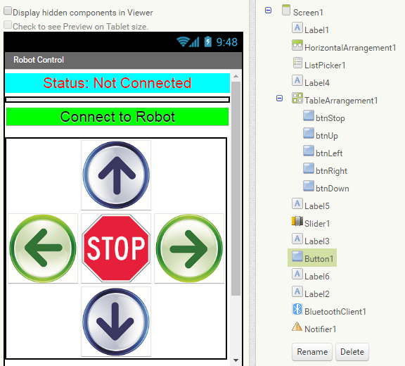

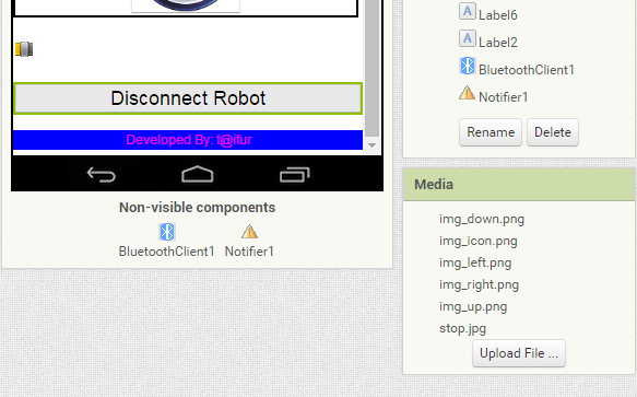

5. Add a Label, a ListPicker, 5 Buttons, a Slider and another Button.
6. Then add two Non-visible components (BluetoothClient1 & Notifier1)
7. I used 5 images for five buttons (4 arrows & 1 stop), you have to upload image in media section first to do that.

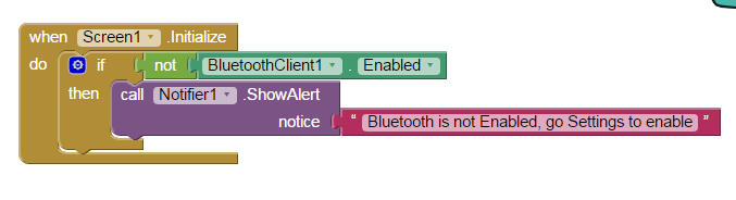

1. App Initialization: The first step is to check that Bluetooth is activated or switched on. If not, an error message is displayed reminding the user to open Android’s Settings and then switch Bluetooth to on.
The Initialize event occurs when the app is launched – and this is a good place to check whether or not Bluetooth is enabled on the device.

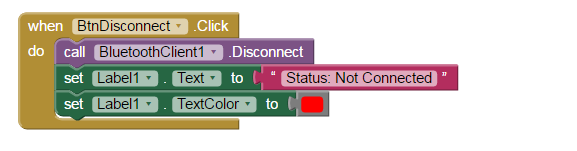

When disconnect button is click BluetoothClient1 become disconnected and Label1 text changed to Status: Not Connected in red color.

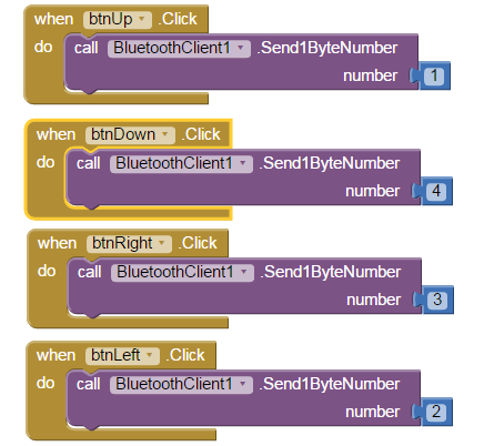

When anyone from 5 control buttons (Up, Down, Left, Right & Stop) is clicked then it sends 1 byte unique number to the receiving device (HC-05 connected to Arduino).

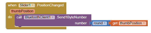

When slider position become changed it sent the current position to the receiver.

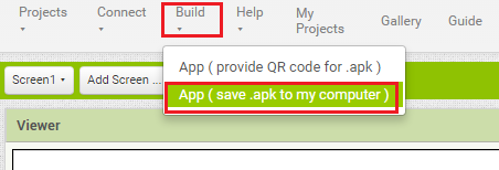

Click to Build menu and select save .apk to my computer. A .apk file will be generated and downloaded to your computer. Transfer it to your mobile phone and install in your device.
Complete source file (.aia) is attached below. You can import it to your App Inventor account from project menu and modify it as your desire.
