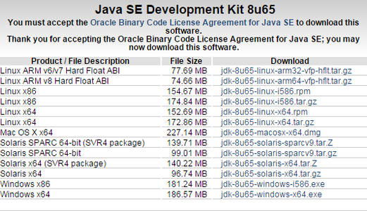

Then you need to download JAVA JDK. Either 64 or 32 bits It depends on your system. If it is compatible with 32 bits download Windows X86 and if it is compatible with 64 bits download Windows X64.
Make sure you keep all the default settings for stuff you are installing so Android Studio knows where to find it. When you install the JAVA JDK make sure to memorise or write down the "Destination Folder" since you are going to need it when installing Android Studio.

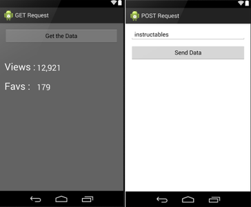

So, my example app is going to be about retrieving the number of "Views" and the number of "Favorites" that I have collected for one of my instructables articles from the HTML source code of the page and displaying it on the device's screen.
The first you wanna do is to go to the Android manifest.xml file and add "android.permission.INTERNET" since we are going to make the HTTP request using internet connection which is obvious.
Second you need to setup a TextView in activity_main.xml that you are going to use to display the HTML source code of the specified website and a button that when we click on it, the app displays the code.Then you also need to declare a new varible "TextView" in MainActivity.java and associate it with the textview in the activity_main using its ID.

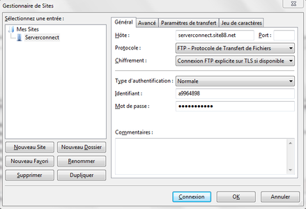

You can create a free website using their free subdomain service then just follow their instructions and you should receive an email that lists your FTP Username and FTP Password and your website will be fully functional within 24 hours.
After you will actually need a software that allows you to send the files (php, HTML , images ...) from your computer to the host servers and to do that I used FileZilla you can download it from here.

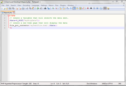

Before sending any file we need to make a file, so in this example we need to make a php file that we will name httppost.php using NotePad ++ ,which you can download from here, (check the image above for the code and a little explaination).After creating your php server file you are going to actually send that file to the servers that host your website and this is where FileZilla comes in,to accomplish that we first need to establish a connection between your computer and the host servers then you right-click on the file that you wish to send ,in this case httppost.php, and then transfer.
Now after setting up our website it's time to make the app that will send the HTTP POST Request . To do that we need to start a new project "I already described it in the GET Request". So first we need to add the INTERNET permission in AndroidManifest.xml just like in the GET Request and then we are going to make an EditText which will allow us to type the data that we wish to send and a pushButton .
