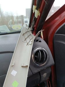

Your embedded radio is normally removable and fixed with 4 Torx screws in my case. To access them, you have to remove the cover which is clipped together. It is not an easy operation, even with the tools supplied with the radio. I damaged a part of the cover, not knowing it was in fact made from two pieces of plastic. I also had to reassemble the two parts before putting it back. In my setup, you also have to remove the cable for the central lock of the car to access the radio. There are no screws holding them, but they require some force.
There is another cover (having the car side windows buttons) that you can also unclip in order to have a nice access for your USB connectors and 4G SIM slot. You will feel two little holes below, which gives enough grip to pull it. Don't go too far, there are plenty of cable connected to this panel. Use the two holes to make the USB/4G cables pass. Then, clips it back once in place.
The third cover to detach is the one used to mask the cables going to your roof (for the lamp I guess). It is also a plastic piece to pull.

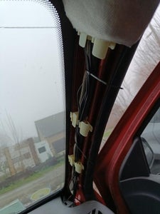

To pass the cables, I first put one of the connectors in the hole on the bottom right of the windshield, going behind the storage compartment of the car (see illustration). You have plenty of space behind the storage compartment, but reaching the cable from the radio hole is difficult. I used a rigid cable to catch and pull it. Then, use masking tape to stick the others needed cables (I have three cables going this way: GPS, 4G and microphone) to the one already in place, and get there to destination with a back and forth movement. The roof cover is not really fixed, so you can push the cables under it until reaching as close as possible from the top center of the windshield (only if you can live with the idea of having the radio permanently fixed).
Now, you have to connect all the remaining connectors, and don't forget any of them ! If you attach the antennas like I did, you have only one try ! Check also if the CAN bus is working properly.
Glue the antennas ONLY when everything is tested and working, so you can get the maximum cable length if the impossibility to remove the radio is not an issue for you. If it is, try to find a nice place to put the antennas closer from the radio to gain some cable length (to be able to remove the radio).
