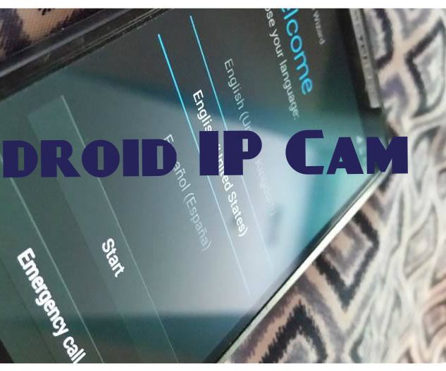

Introduction: Android Security Camera Network
My second instructable! This is my next logical step in my path to creating a cost-effective and flexible security network for my home/office. If you'd like to see how I started this - please do. I will not be covering how to make another low-cost security camera from an android device again in this instructable but will be describing how to setup your network properly.
We shall cover
- Using/viewing more than one device.
- Giving our android devices private static IP addresses for easier viewing.
- Setting up port forwarding.
- Viewing our IP cameras from outside the private/home network.
- Getting the maximum uptime out of our cameras. (Reducing software failures and issues.)
- As a bonus we will also cover how to make some of your in-home devices do some double duty.
