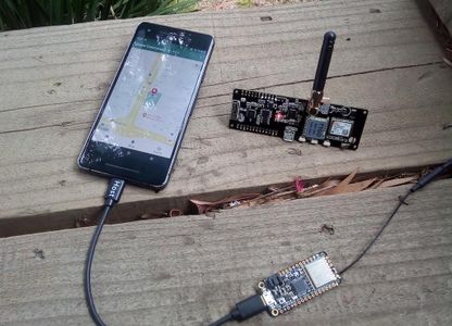

At a minimum you need a 'Home' radio module, which you connect to an Android handset or tablet (either via USB-OTG cable, or over Bluetooth), and a T-Beam module as the tracker device.
More ambitious setups can involve multiple T-Beam devices, all remotely monitored from the Android + Home radio. You can also deploy dedicated solar-powered repeaters to extend the coverage area that the tracker devices may be in.

This can be one of a wide variety of LoRa development boards, including the Adafruit Feather (as in the cover picture), or the TTGO LoRa32 V2, or Heltec V2. You just have to flash the Ripple Messenger firmware onto this radio, for it to operate in this role with the Commander app.

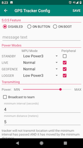

To program the ID and settings into the T-Beam device, you need to launch the DeviceProvision screen. Note that the Commander app has two Android launcher icons! The 'Device Provision' one is for doing this initial setup/config.
In this screen just connect the T-Beam with a USB-OTG cable, then select the 'allow' button in the Android security popup (to allow the app access to USB peripherals). A dialog box should then popup asking if it's OK to add the new device. Select 'Yes', then enter the ID you wish to assign, some unique name of the device, then click 'Save' button.
Tap on the '...' button to the right to setup custom configuration properties for this device (screen is pictured above)
If you want to use the SOS feature, select the ONBUTTON option, and enter some text to be sent on SOS being activated.
The 'Low Power' options for the various modes cause the device to go into deep sleep for varying periods:
- Low Power1 - sleeps for 30 seconds
- Low Power2 - sleeps for 2 minutes
- Low Power3 - sleeps for 10 minutes
- Low Power4 - sleeps for 30 minutes
After waking from deep sleep, the GPS is powered on (if the 'Peripheral' checkbox is ticked) and attempts to get a location fix. Depending on the mode, it then processes the location, then goes back to sleep.
The NORMAL power mode just keeps everything powered on.
Typically you want the LOGGER mode to use one of these Low Power modes, to configure how often you want to capture the geo location, and how much you need to conserve the battery.
Tap on the SAVE on the toolbar, then 'Save' on the device screen, to save the configuration options.
The 'Save' button should then change to 'Program'. Click this to then send all the settings to the T-Beam.
NOTE: If you ever want to change this config, you can, but afterwards you will need to attach the T-Beam again and click 'Program' again.

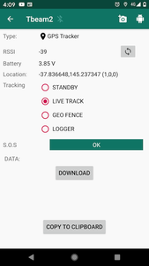

Launch the main screen from the other launcher icon, labelled 'Ripple Commander'. You should see a list of devices you have configured.
Connect the 'Home' radio, either via USB-OTG cable or Bluetooth. The toolbar has an icon that shows the connection status which changes to solid white when connection has been established. Also, the 'Home' device's battery voltage will then also appear on the toolbar.
Tap on the T-Beam device in the list of devices, to see the device info screen (pictured above)
If the device is not reachable or something went wrong, the RSSI will say 'Timed out'. Tap on the refresh icon to the right to retry fetching the device's status.
NOTE: if the device is reset since you powered on your 'Home' radio, you must tap on this 'refresh' icon to re-sync the status of the tracker device.
Step 6: Changing Modes
Tap on the radio buttons (Standby, Live Track, etc) to change the current tracking mode.
Note: if the device is currently sleeping, you will have to wait until its next wakeup to see the mode change.Alternatively, if you can physically access the device, you can reset it, in which case it will go back to LIVE mode.
Mode: Live Track
If changing from 'Standby', the GPS is remotely powered on. Once a fix has been established you should see the Location: property changing. You can also select the Back navigation, then select the 'Map' tab to view it as a pin on the map.

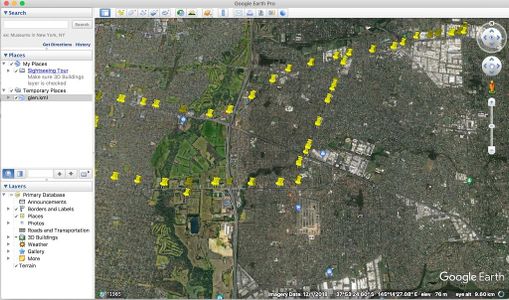

Mode: Logger
This will typically put the device into deep sleep (you should see the red LEDs on the T-Beam go off), and on waking writing the acquired geo location and timestamp to the T-Beam's SPIFFs partition.
At any time you can switch the mode back to LIVE TRACK, then click on the 'Download' button to download the captured data. Note that this will be quite slow, as LoRa is only a low bandwidth modulation technology. But the cool things is this can be done remotely, so for something like wildlife tracking collars means you don't have to re-capture the animal!
The data will be presented as CSV data in the box below the progress bar. If the download stalls/fails you can click on Download again and it should resume.
Click on the 'Copy to Clipboard' button to copy the CSV data to the Android clipboard.
For example, you can then either paste this into an email, or paste it into a note in an app like Google Keep, then process it on the desktop.
In this test, I had the tracker on the dash of my car (configured with Low Power1). I copy/pasted the CSV data to a Google Keep note, then on my laptop copied the data to a.csv file, imported to a CSV to KML converter, then drag-n-drop the KML file onto Google Earth (pictured above).
