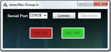

Step 4: Step 4. Config Your Box
0.) Switch off the bluetooth power supply (only).
1.) Open Android_tv.exe in --------- [ software/pc/ARDUINO_TV.exe ]
2.) In Box Setting -> select your arduino port and press connect button
3.) Go to the "Program Remote" Tab.
4.) Press Start Button for programming the "BOX"
5.) Press "0" button from your Tv or Set-top Box Remote .
Note: If u press any button from your remote for long time then may be you will see "FFFFFFFF" in your Code text box! (don't press button for long time)
6.) Then press "SET" button in software At "0." position, You will get Code back in the text box (right side of "SET" button At "0." )
Note: ignore "0" at even number of the code back in At (right side of "SET" button At "0." ) see forth image
