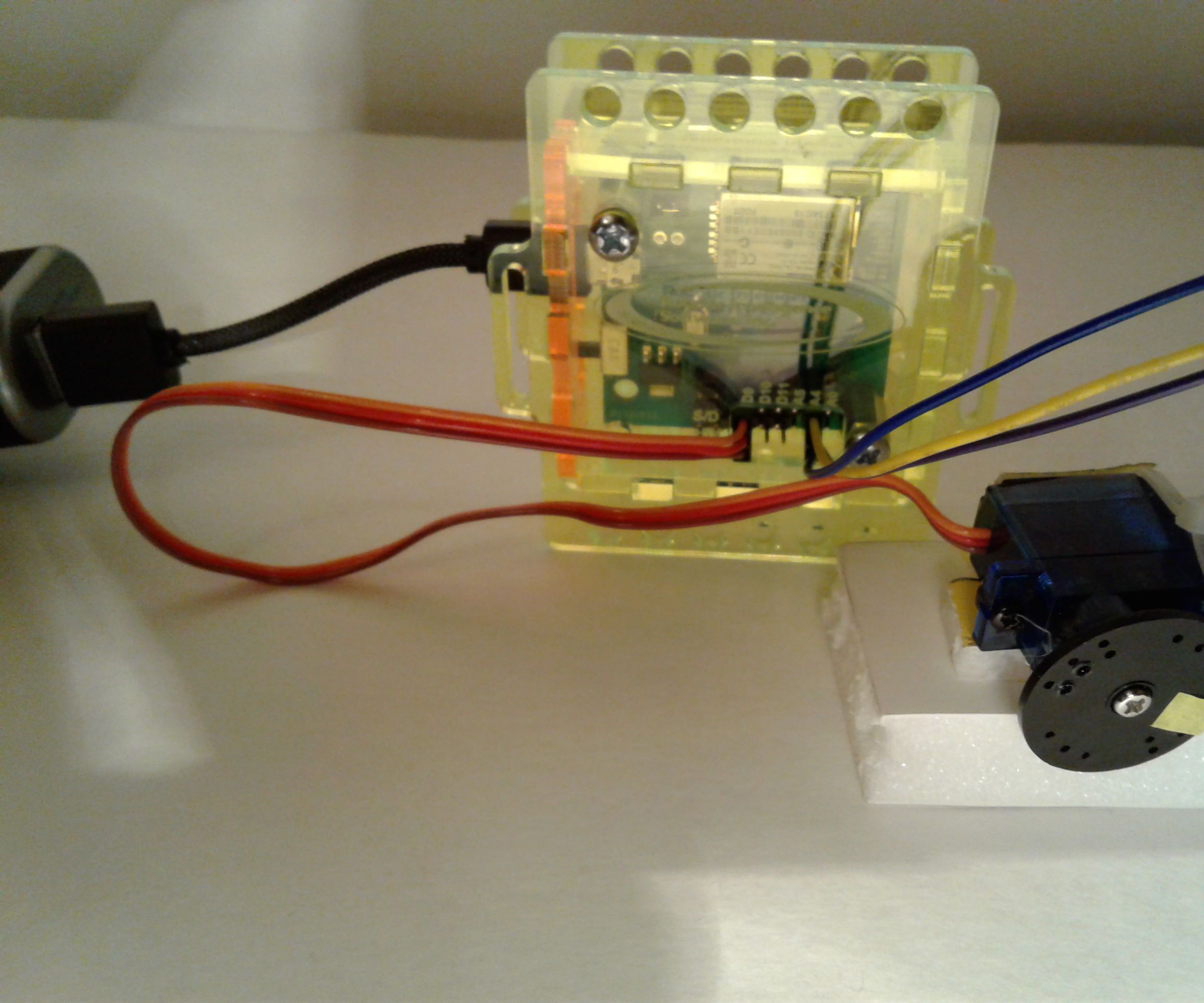

Step 11: Make Electrical Connections
- Attach the Left servo motor wire to the D12 pins of the Android Robot Controller. The black or brown side of the servo cable should be connect with the bottom GND pin
Attach the Right servo motor wire to the D13 pins of the Android Robot Controller. The black or brown side of the servo cable should be connect with the bottom GND pin
- Plug the 9Volt barrel connector into the 7 - 12VDC jack on the Left side of the Android Robot Controller
