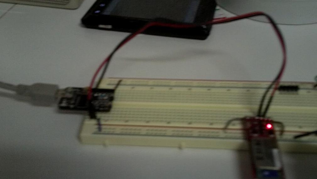

Step 3: Change BAUD Rate on BlueSMiRF Gold
Change the BAUD rate from the default 115.2k to 57.6k.  If you leave the BAUD at 115.2k, the parallel LCD will display gibberish when you send a message from Android to Arduino.  If you set the BAUD below 57.6k, the Android phone will "cut up" the message that the Arduino sketch sends every 30 seconds.  So 57.6k BAUD is just right.
*Commands to set BAUD: http://www.sparkfun.com/datasheets/Wireless/Bluetooth/rn-bluetooth-um.pdf
*Video instructions on how to change BAUD:
https://www.instructables.com/id/Change-BAUD-rate-on-BlueSMiRF-Gold/
FTDI Basic chip: http://www.sparkfun.com/products/9716
