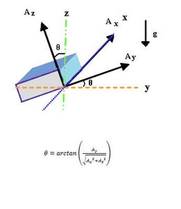

To measure the angle using an accelerometer we have to sense the gravity in each axis of the accelerometer, what it means, the projection of the gravity acceleration on each direction of the sensor give us an idea about the angle. [angle_accel = arctg( Ay / sqrt( Ax^2 + Az^2 ) )]

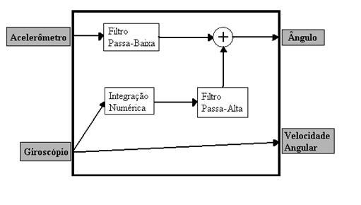

And how to merge both signal?
We will use a technique called complementary filter. I don't know the exact theory behind this, but it works fine. There are some information at the internet, just google it if you need more information. This link has a lot of information and can be useful.
filtered_angle = HPF*( filtered_angle + w* dt) + LPF*(angle_accel); where HPF + LPF = 1
The values of HPF and LPF can be found at this link, on the filter.pdf file. Thanks you guys from "The DIY Segway".
Just for test purpose we gonna set this values like this, HPF = 0.98 and LPF = 0.02.
