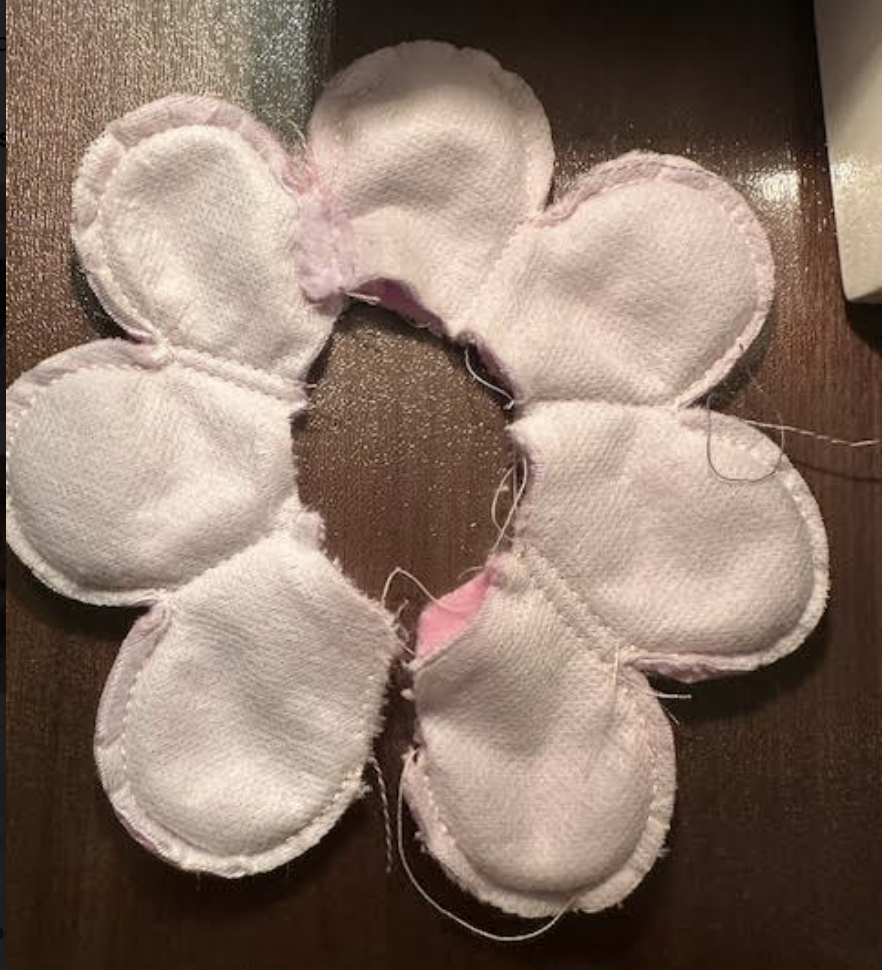

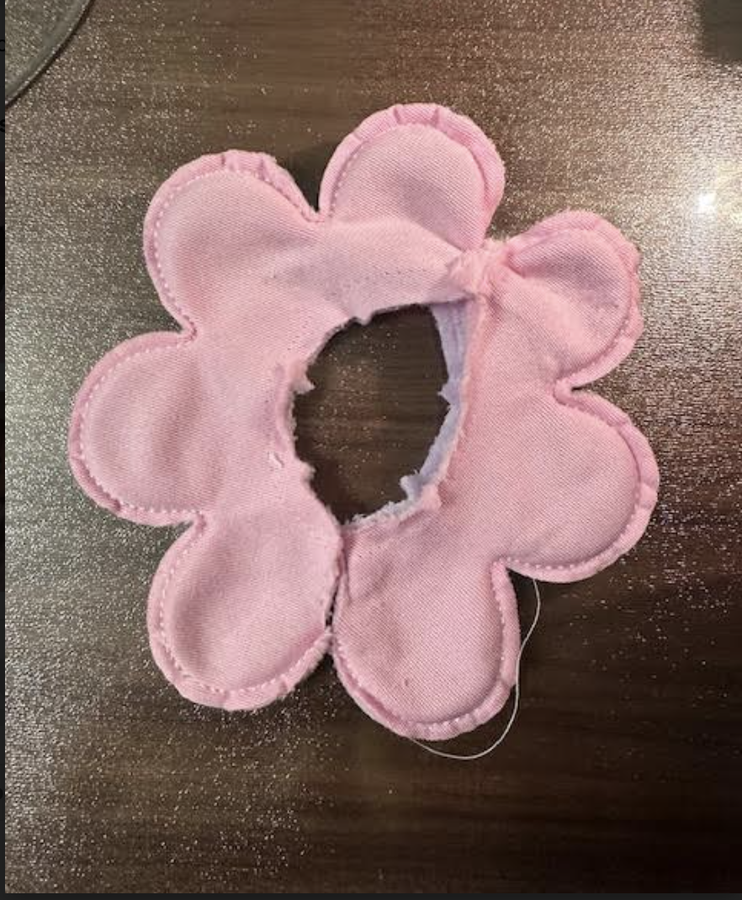

Step 6: The Octopus
For this project, I deconstructed the octopus stuffed animal. I used a seam ripper and carefully went through and broke the seams that connected the body and legs. Once I did that, I was left with 3 pieces of fabric:
  • The head with stuffing in it
  • The head that was flipped inside
  • The legs
For the legs, I separated them so that they could cover each servo arm. To do this, I chose to use a sewing machine.
To hide the seams, I removed the stuffing from the legs and flipped the fabric inside out.
Then, my mom taught me how to use the sewing machine. I used a straight stitch and essentially sewed through the fabric where I wanted to separate the legs.
After sewing, I cut off each of my legs and flipped them right side out, so that the fluffy fabric was on the outer side. I did this so that no seams would be visible from the outside.
Now, moving on to the head. With the head stuffed to my liking, I determined where the connecting Velcro strip should be on the lid. Because the head fabric is not flat, I hand-sewed the Velcro strip onto the back of the head. I started off doing this with no stuffing inside, but having some structure inside really helped when hand sewing.
