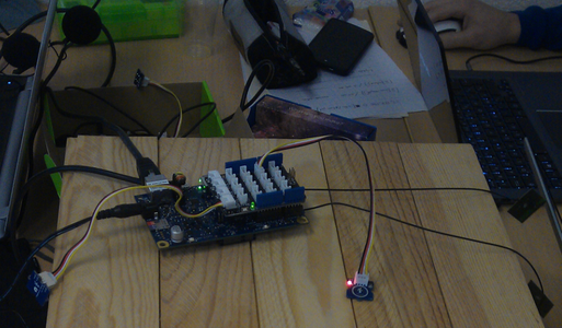

Step 2: Use Intel Galileo As Local Hub to Integrate Pet Equipments
We use Intel Galileo as a hub:
- to connect the equipments extended with arduino + specific sensors and actuators
- to act as a centralized gateway to the internet (and in the future to the smart home ecosystem)
- collect information from standard sensors: presence of the pet near the equipment,
- to collect the variation of weight of the food or water in the bowl
- to trigger the delivery of one food portion by the dispenser
