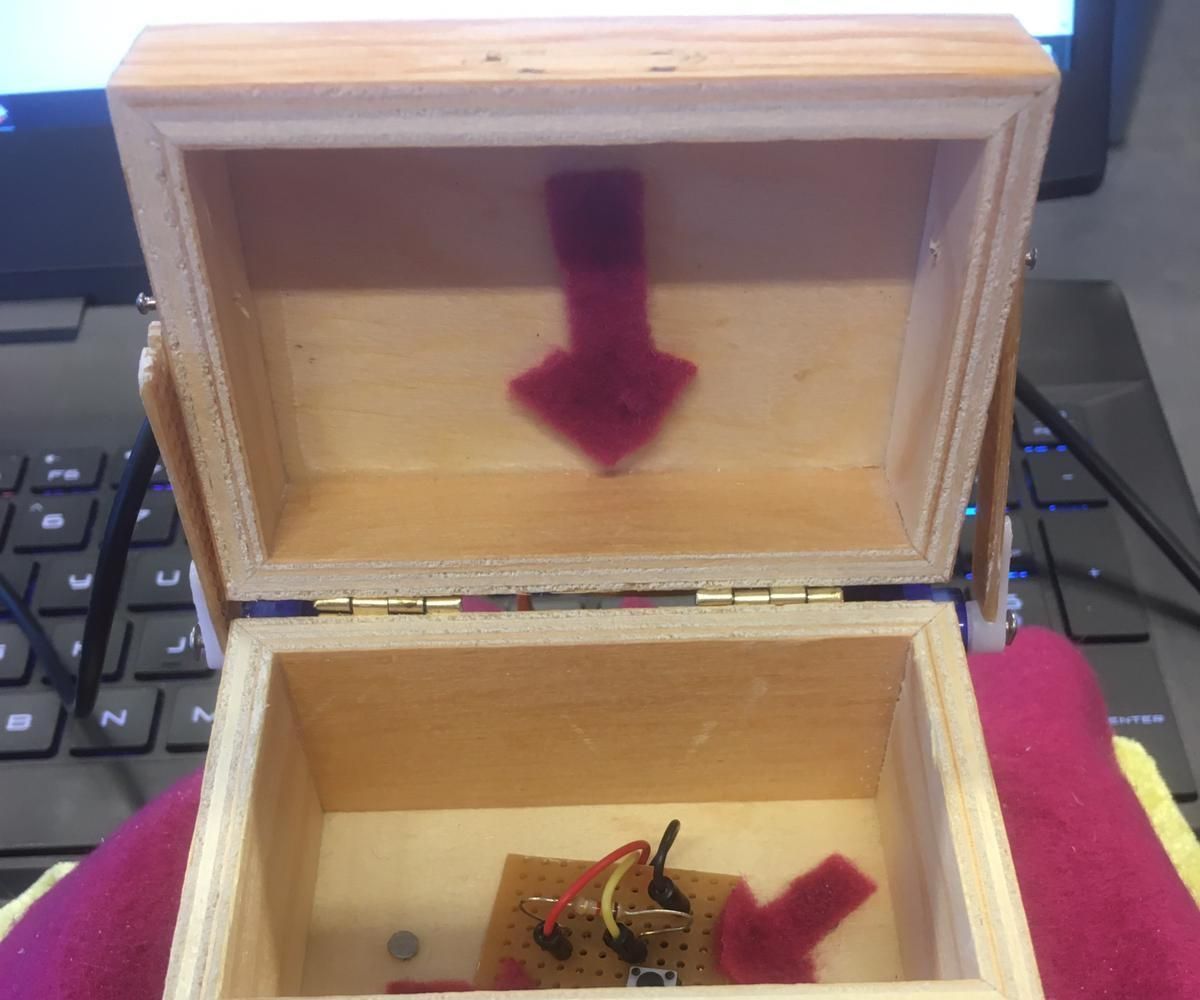

Step 3: Putting the Mailbox Together!
Now that you've set up your wires, you'll need to put together your mailbox! This is as simple as making a box with a slot and a lid, and a hole in the side.
After you've put it together and decorated it to your hearts content, you can put all your wires in.
Start with gluing the servo motor to the side of the box, so the little arm sticks out of the side, to attach your flag to.
Then, make sure you have a cover to hide your wires, and attach the Force sensitive resistor on top of it.
Then you'll want to make a little platform with springs, as otherwise the Force sensitive resistor won't work.
Use five springs, one for on the sensor, four for on the sides, and then put some cardboard on top.
After you've attached your platform to your sensor, and you got your mail ready, you're good to go! Enjoy your cool new mailbox.
