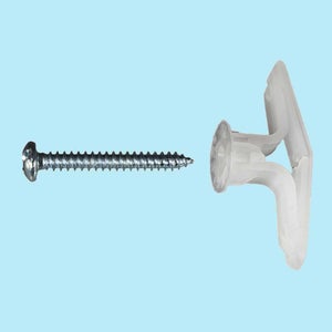

  5. Toggle style nylon picture hanger - you won't need the screw. Available from Home Depot

  8. Something to use as a bracket on your motor. I used a leftover nylon wall hanger

These little N20 motors typically come with a connector, which you must cut off. Strip the wires, and tin the ends with solder. Grab a small 1.5 volt battery and test to make sure the shaft turns. . Simply shove the shaft into the screw hole of the nylon hanger. Adhere the nylon hanger to the shaft with super glue if it slips.

I don't have a photo for this part. After you are done playing with the jaw opening and closing using the smaller paperclip as a push rod, figure out a reasonable length that will open and close the jaw without lashing as the motor turns. This is the part requiring patience. Once you have the length worked out, bend the paperclip to engage the motor linkage (the nylon hanger). Use your finger drill to make a hole through the nylon hanger then insert the paperclip pushrod into it. Use pliers to put a bend on the paperclip so it does not slip off the motor linkage.
