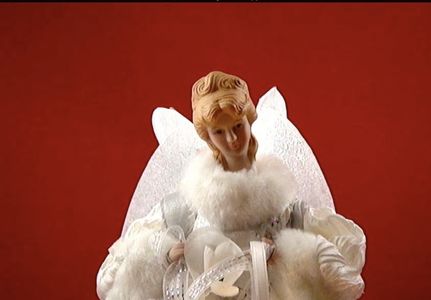

To top my tree, I wanted an illuminated angel with flapping wings.  When I couldn't find one, I made my own using a flapping butterfly (scientificsonline.com) and a "Direct LED G4" from earthled.com.  I started with an angel topper from KMart and went from there.

Step 6: Make Wings
 Use acetate (the clear stuff that you used in school to make your book reports look better than they were) and paint it white.  Apply as much sparkly glitter as possible.
Step 7: Tape Acetate Wings to Butterfly Wings
 I used packaging tape for this.

Step 14: Attach Bracket to Angel
 Inside the tree topper angel is a thick plastic "cone."  Drill holes to match the bracket holes and secure the bracket with two small nuts and bolts.
Step 15: Attach Tie Down to Back of Angel
 Poke a hole through the back of the angel.  Insert wire (I used #24 magnet wire) through this hole.
Step 16: Tie Butterfly Wings to Back of Angel
