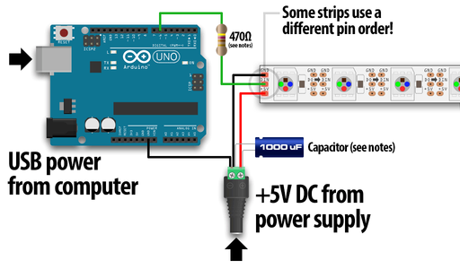

Step 3: Circuits and Coding
  • Adafruit has excellent tutorials on using RGB lights with Arduinos, so I won't try to repeat them here.
  • We wired up the Arduino to the appropriate resistor/capacitor and soldered everything to the perf board.
  • We then put the electronics into the project box and drilled a hole for the barrel connector.
  • We plugged it in a it lit up like a charm!
  • In order to get some cool lighting effects, we cannibalized Mark Kriegsman's excellent TwinkleFOX code. This code allowed us to use the FastLED library to make all kinds of holiday lighting effects very easily.

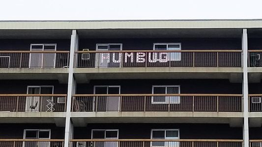

Step 4: Mission Accomplished
Finally we hung the sign in our window.
Christmas season has officially begun!
