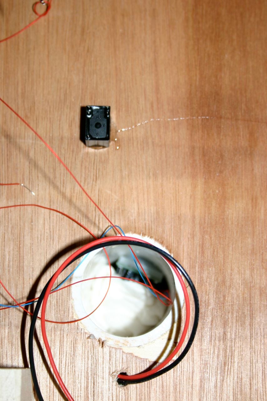

Step 24: Place the PVC Tube Into the Plywood
You should be able to get a snug friction fit of the PVC into the hole in the plywood. If the PVC is too loose, wrap electrical tape around the pipe until you can obtain a snug fit.
Step 25: Take the Speaker Wires and Place Them Through the Plywood
Step 26: Add the Positive Wire From the Motion Sensor to the Switch
Note the little loop in the wire wrap wire. If I failed to identify that wire earlier, I wouldn't know which wire goes to the switch. (3) on the schematic.
Step 27: Connect Negative From Motion Sensor to Battery Negative
(4) on schematic

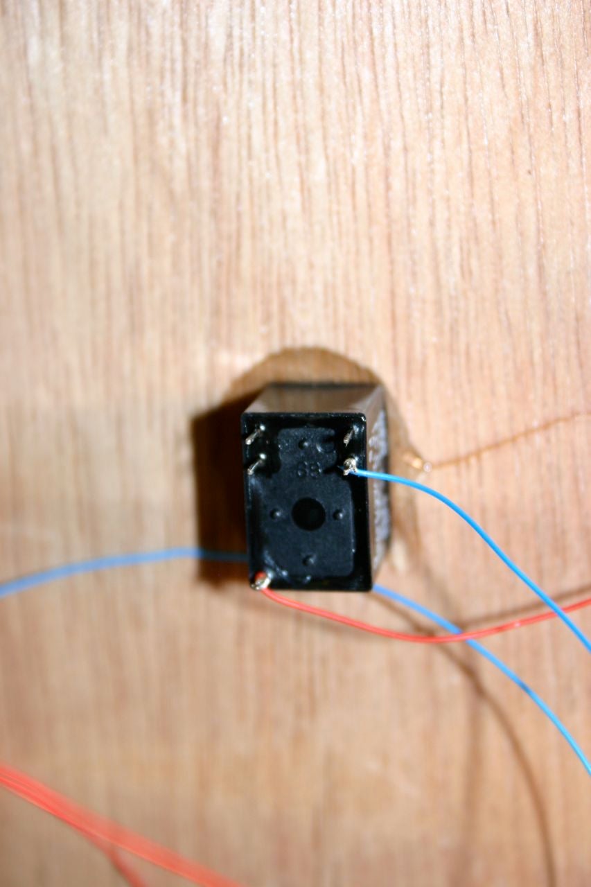

Step 31: Glue a 5 Volt Dc Relay to the Bottom of the Plywood
Step 32: Attach the "play" Button Wires From the Module to the Relay (N.O. Contact)
(7) on the schematic
Step 33: Connect the Motion Sensor Output
This is the output from the motion sensor, through a 270 ohm resistor to the base of a NPN transistor.
(8) on the schematic
Step 34: Connect Battery Negative to the Transistor
(9) on the schematic
Step 35: To the Transistor, Attach a Diode and a Wire (headed Toward Relay)
(10) on schematic
Step 36: Attach Wire From Transistor to Relay
(11) on schematic
Step 37: Attach Wire to Other Side of Relay Coil
(12) on schematic
Step 38: Attach Wire From Coil to Diode
(13) on schematic
Step 39: Attach Wire to Coil, Headed Toward Battery Positive
(14) on schematic
Step 40: Attach Wire From Relay to Positive on Switch
(15) on schematic
