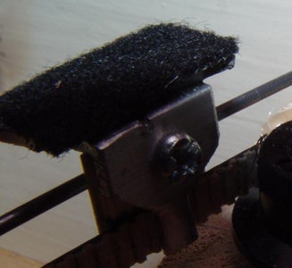

Step 3: Build the Magnet Bracket
Next I built the magnet bracket that attaches to the toothed belt. This was so I could then work out what height the stepper motor and pulleys needs to be mounted in the box. I cut two small pieces of aluminium angle. One of the pieces was been shaped to allow it to securely clamp the belt, yet still smoothly pass over a pulley. The other was cut into a small square.
I then drilled through them both, and used a small bolt and nut to clamp them to the belt.
Next I epoxyed a chunk of strong (neodymium?) magnet broken from a larger flat magnet pulled out of an old hard drive.
I stuck some felt on top of the magnet as a low friction surface.
A note here: you need to use a non-ferrous metal for the bracket otherwise it will cause problems with the magnets - e.g. it will get stuck somewhere, or worse will affect the magnetic field and make the magnet seem weaker.

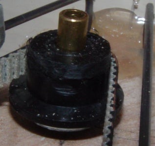

Step 5: Pulley Shafts
With the pulley blocks and layout ready, we need to install some shafts for the pulleys to run in. I had some brass stock that was the right size, so it was simply a matter of cutting off 3 lengths (you will need the third in the next step), drilling the holes in the pulley mounting blocks and expoxying them in.
I then waited for the epoxy to set, then slipped two washers over the shaft to get the pulley to the right height - to make sure the bracket runs flush with the 'lid' of the box
Step 6: Set Up a Tension Pulley
Now we need to setup the tensioning pulley - this is to keep the belt tight enough to engage the stepper motor, regardless of any slop and inaccuracies in the build, but also shlould allow the belt to slip if something goes wrong, without breaking anything.
I soldered the third shaft (from previous step) onto some scrap metal (from an old heatsink) with a hole for a pivot at one end, and a hole for a spring at the other. I then used a screw to loosely mount one end, and the other it pulled by some springs (pulled from old pens) to keep the belt tight.
The tension is not very critical at all - you just need enough to make sure it doesn't slip.

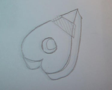

Step 10: Make the Planchette
Next I needed to make the planchette. I decided after a few sketches, and after how my lid came out that I would like to have a bit of a steampunk theme, so I designed it in that way. Whatever you want to make, the main parts of construction still are applicable.
I looked around for what a planchette should look like, and there are infinite variations, but a majority look like a 'stretched love heart' shape. I sketched out this shape onto some scrap 6 mm ply (left over from the base of the box) and cut it out.
Next I drilled the hole which is pretty common on the planchettes I have seen.
