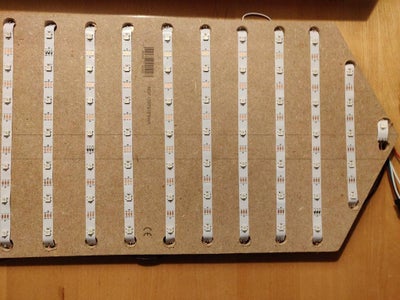

Step 1: Building the LED Backend
Instead of writing this up I'd like to mention that I followed Thomasj's instructable almost to the letter but only steps 6,7, and 8 - so leaving out anything to do with the ping pong balls!
I first started cutting the LED strip into strips of 7 (plus two of 1 and one of 5) and soldering them together like in his instructions. This gave me a series of LED strips with flexible wiring interconnects, which I then mounted to a board of triplex. This part is pretty much identical to his, only he terminates the LED strip with 3 LEDs at the right end instead of the 1+5 arrangement he has at the left, and mine is exactly symmetrical.
The pictures here are from Thomasj's instructable, and only serve as a guidance to what you should end up with. The only difference in my case was that I used triplex wood instead of MDF. As I mentioned, I forgot to take decent pictures at this time, but it shouldn't be too difficult to figure out for yourself with thomasj's instructions.
I first drew out the configuration of the LED strips on the wood before cutting it up and mounting everything. I drew it out to end up with a grid of LED's in squares, but the vertical distance between strips doesnt matter all that much. The LED strip I'm using here has 30 LED/m (a spacing of 3.33cm between the individual LEDs) so I spaced the LED strips 3.3cm apart as well. I added rounded ends, could easily have been square (which would have probably made coding easier).
