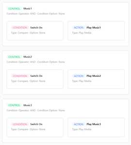

Step 3: Logic-Music Playback
Control 1-3: Play Music Tracks
Create three controls to play three music tracks sequentially.
  1. Condition (Compare): Play = True
  2. Action (Play Media): Create media player, command = Play, upload music file
Duplicate for each track with different music files.
💡 Tip: When multiple controls exist in the same logic, they execute sequentially. When the third track finishes, it loops back to the first.

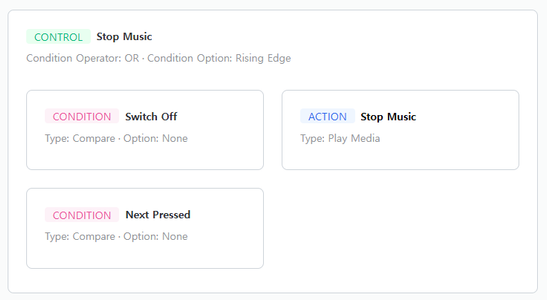

Step 4: Logic-Stop Music
Control 4: Stop Music
Stop playback when switch is off or Next button is pressed.
  1. Condition 1 (Compare): Play = False
  2. Condition 2 (Compare): Next = True
  3. Condition Operator: OR
  4. Option: Rising Edge
  5. Action (Play Media): Command = Stop
