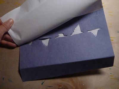

You should have as many frames in the animation as you have LEDs. In my example I used 5 frames of a bird flying, and 5 LEDs. Once you have decided what you will animate, draw it onto thick(ish) paper (I have used construction paper in this example, but you could use cardstock), and use a craft knife to cut it out (or use a vinyl / laser cutter if you have one handy!).
Step 2: Fold Your Switch on the LED Page
Step 3: Fold You LED Page in Half
Step 4: Cut Your Frame Page to Size
Step 5: Cut Out Your Frames
Use an craft knife to cut out the animated sequence you chose in step 1

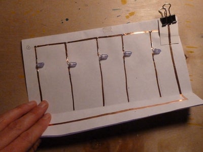

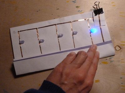

Step 6: Add LEDs
Mark everything out in pencil first.
To get the position of the LEDs, position your frame page on top, and make a small pencil mark at the center of each cut-out frame.
Lay copper tape as in the diagram -note that if you have any breaks in the tape you will need to solder, as most copper tape is only conductive on one side.
Add a small piece of card to connect the battery to the switch. This can be glued or taped.

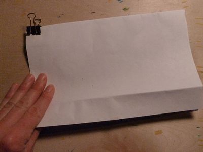

Step 7: Add Battery and Clip

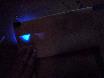

Step 8: Sandwhich Frames
The LEDs will be at the back, with the frames in the middle, and a blank page at the front...for the magic to happen!
