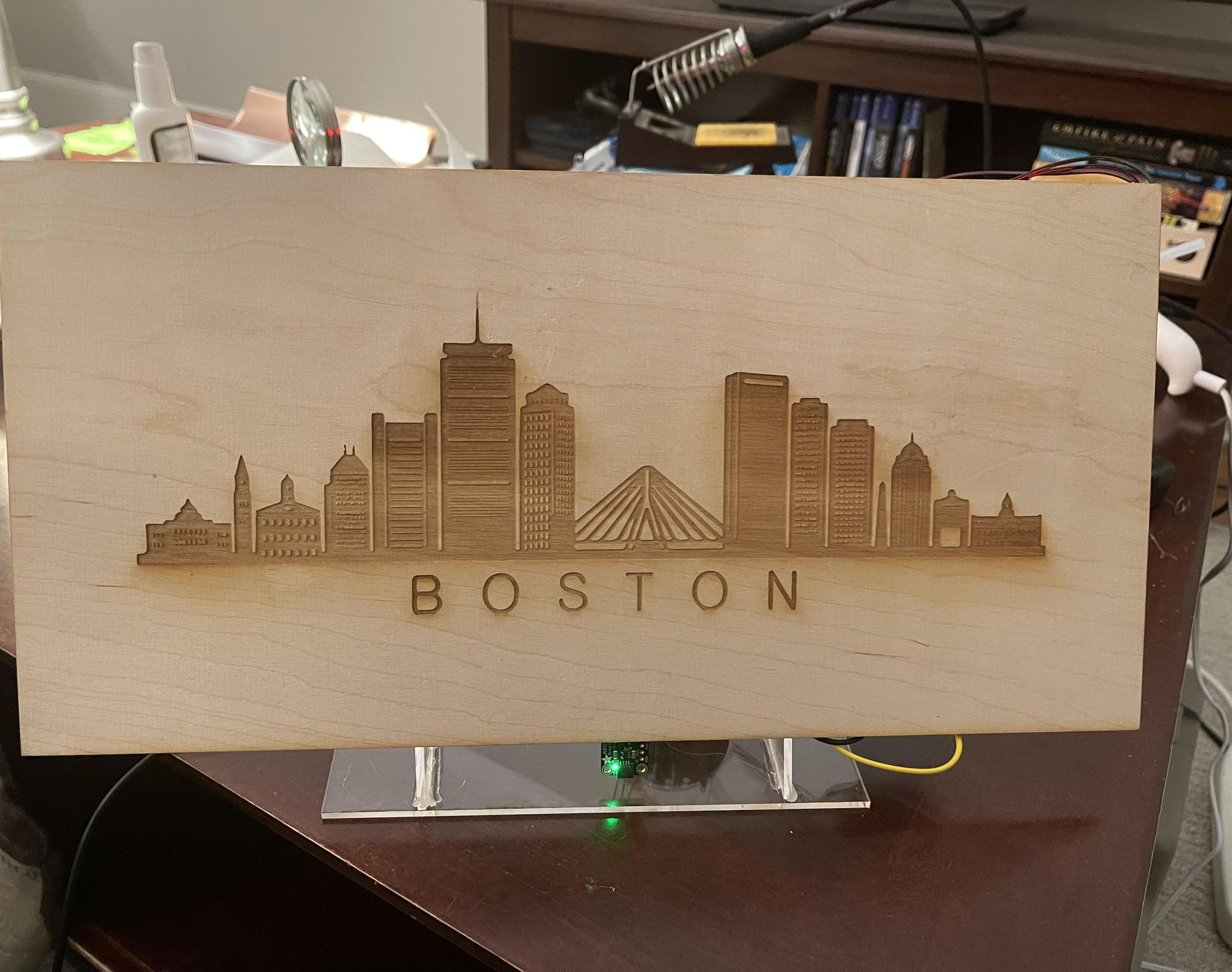

Step 1:
Sketch the image you want to engrave and format it in illustrator. Then push project to a laser cutter that will engrave it into 1/8th inch baltic birch.
Step 2:
Tape or glue the LEDs into the whole that were cut for them and wire them into the CPB
Step 3:
Glue the speaker down and wire it correctly to the CPB
Step 4:
Wire the button in and seat it properly into the face of the project
Step 5:
Measure and cut out a stand and attach it with hot glue and measure out a box to enclose eveything in. You can use cardboard or wood.
Step 6:
Code whichever animations and sounds you'd like.
