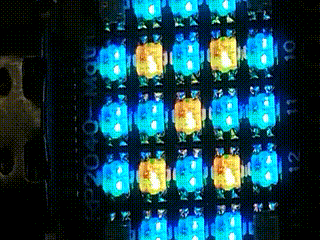

The RP2040-Matrix is a compact and charming development board that features a tiny 5x5 RGB LED matrix, along with the RP2040 microcontroller. It can be easily programmed using MicroPython. In this project, we will make it display random animated symmetric patterns. Possible use cases include electronic jewelry, trinkets, and holiday decorations.

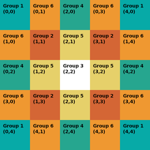

Step 1: Defining Pixel Groups
I defined six pixel groups. Each pixel in a group will have the same color.
In MicroPython, the groups are implemented using a 3D list.
pixel_groups=[[[0,0],[4,0],[0,4],[4,4]],\
[[1,1],[3,1],[1,3],[3,3]],\
[[2,2]],\
[[2,0],[0,2],[4,2],[2,4]],\
[[2,1],[1,2],[3,2],[2,3]],\
[[0,1],[0,3],[1,0],[1,4],[3,0],[3,4],[4,1],[4,3]]]

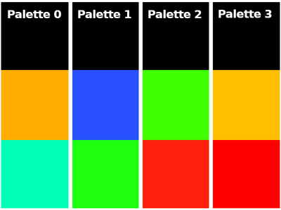

Step 2: Defining Palettes
Each palette consists of three colors. The black color corresponds to a turned-off LED. The sample palettes in the picture are not equivalent to what is defined in the code. The LEDs look different from the pixels on your screen.
In MicroPython, the definition will look like this:
palettes = [[[0,0,0],[32,22,0],[0,22,16]],\
[[0,0,0],[5,10,32],[4,32,2]],\
[[0,0,0],[12,44,0],[48,6,2]],\
[[0,0,0],[32,24,0],[32,0,0]]]
