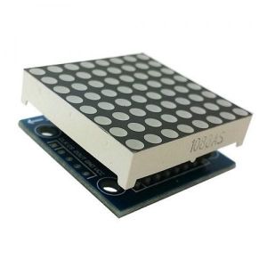

- LED Matrix 8*8 with MAX7219 Module (my led matrix had a blue board, however, I'm pretty sure you can also use the green one the same way)

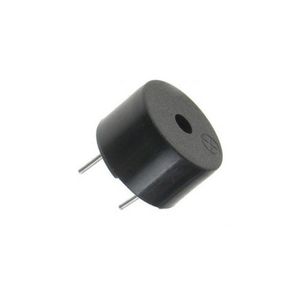

- Buzzer

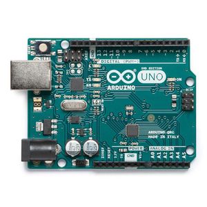

- Arduino Uno

After I made sure my sensor worked, I started to try out the buzzer. Might as well add sound to the sensor while I wait until my LED matrix arrived.
So I followed this tutorial, making sure I understood the way it worked, so I could later make my own sounds.
https://www.codingkids.nl/arduino-buzzer.html
Once my matrix arrived, I started work on that with this tutorial by Rui S.
https://randomnerdtutorials.com/guide-for-8x8-dot-matrix-max7219-with-arduino-pong-game/
I only used the first half, because I did not need a pong game for my project.

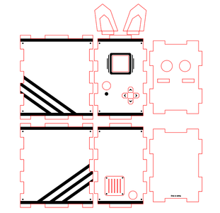

Step 4: Housing
Be sure to make a little house/ body for your robot, as they'll very much like that.
I designed mine in Adobe Illustrator and used a laser cutter to cut it into wood.
Sadly, however, while cutting it went wrong, and I had to start over. This made me lose a lot of time and I had to scrap the engravings I had planned.
