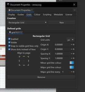

Then we want to set up the our document and tool properties before we start creating. To do this we'll open document properties (File -> Document Properties -> Grids), then select a new rectangular grid and make sure the spacing for X and Y are the same value (this value can be changed but keep them equal for a square grid). Then make sure that "Major grid line every" is 1 which will help with snapping and keeping everything clear. Ticking "Show dots instead of lines" will also free up the canvas a bit as well.

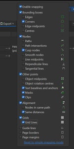

Lastly, make sure that snapping is enabled. With the sub categories Bounding boxes -> Corners, Nodes -> Cusp Nodes, Grids -> Grid Lines are all enabled as well.

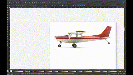

Now our settings are all setup, we get to start the fun part - actually creating some pixel art. Start by just using the rectangle tool to create a square the size of a grid (the snapping will help). Then convert the object to a path, Path -> Object to Path. Once the square is converted you can use the eyedropper tool to match the color of your image and place it.
From there it's as easy as copying the cube, and pasting it along the body tracing out the image. It's a good idea to keep the number of different colors a little limited and not change with every tile - this helps keeps everything looking nice and consistent. But still use some shading to enhance the look.

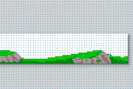

Since the foreground section is quite large, it can help to start with a rough shape, and then use a Bezier curve to fill in large spaces. Remembering it's only the perimeter of the shape that has to be pixelated to give the pixel art effect. The first picture shows these large fill shapes, and after the second the smooth edges have been covered with pixilation, just make sure there aren't any smooth edges showing.
