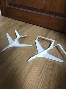

References serve as the backbone of your design process. They provide a visual guide that helps you stay true to your concept and maintain consistency throughout the project. For my animation, I started by sketching the model I wanted to create. Sketching is an excellent way to combine and review your ideas, giving you a tangible representation of your vision.

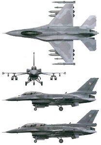

For my jet design, I used the F-16 Fighting Falcon as a reference.Since it has a simple design and overall looks cool
Since I was influenced by the F-16 Fighting Falcon, I decided to call my jet FA-47, combining the letters F-16 and my name, Arush.
Step 2: Importing References
The first step in creating the jet model is to import references into Blender.
After importing the references, I arranged them in such a way that they are mutually perpendicular to each other.

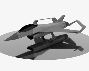

  1. I started by using the references to model the jet's body shape, dividing it into four sections.
  2. Main body
  3. Cockpit
  4. Exhaust Nozzle
  5. Motor Air Inlet (The bottom)
  6. In the material tab, I changed each part's color, roughness, and reflectiveness.
Wings
  1. I repeated the same steps for the wing as well but joined the main and stabilizing wings to give it a futuristic look.
  2. I then duplicated the wing on the opposite side using the mirror modifier.
  3. And finally joined all the parts of the jet using shortcut Ctrl+J.

First, I set up the jet on a circular platform and gave it a reflective metallic texture. Then, I positioned the camera in front of the jet.
