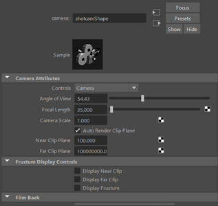

Camera:
  1. Create a camera in Maya by going to Create - Camera - Camera
  2. Now you can rename it (maybe shotcam and add the shot number of the scene)

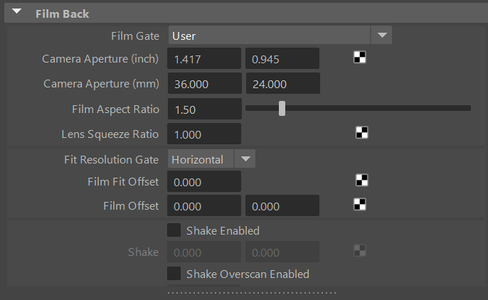

  3. If you open the Attribute Editor while having the camera selected (Ctrl A), you can now change the settings for your camera.
  4. Most important are the Focal Length and the Camera Apeture. The Apeture is describing the size of your sensor, which you can google and the focal lenght is something you have to note down during your shoot, so the render of the dragon matches your footage.
  5. It is best to also note down the height of your camera during the shoot, so you can locate it precisely in Maya, by adjusting its translation values in the channel box. Remember, Mayas default measuring system is centimeters.

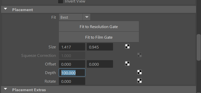

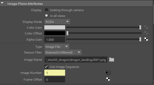

Step 6: Adding Your Footage to Autodesk Maya
For me it is always easier to animate, when having my plate in frame as well. You can do this as you wish, depending on if you have filmed a plate or not.
  1. Change the format of your video to a png sequence in a program like DaVinci Resolve.
  2. In Maya go to the menu over the viewport View - Image Plane - Import Image and navigate to the first image of your image sequence. Be sure, that the file naming convention does not include spaces or characters that are not usual in the english language (e.g. ä, ü, ö). It should also be counting up, like: image_plane.0001.png
  3. Now press "use image sequence" in the Attribute Editor (as shown in the first image) and adjust the Depth, so the images are located behind your dragon (as shown in the second image). The number can be quite high if the dragon is big in size. Also be sure to adjust the Near and Far Clip Plane of your camera to be able to display the image if it is far away.
Now you should be able to see your rig in front of your plate, as in the last image of this section.

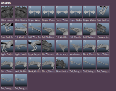

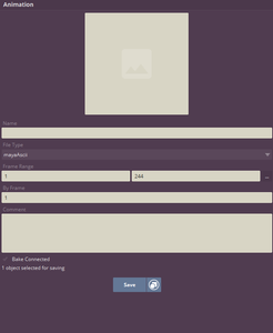

Step 8: Studio Library
One of my favorite tools I frequently use is called "Studio Library".
Here you can basically create a library of your animations and apply those to all of your different scenes. It is perfect for saving out cycles or animation assets.
Saving an animation to Studio Library:
  1. Right click anywhere in the program and select New - Animation
  2. A menu will pop up (second picture in this section). Change your frame range to only include the frames you want and change the Frame Range in Studio Library to the length of your animation
  3. Now give it a name and press the window at the top to playblast a preview for your icon
  4. Select all of your controls and press "save"
Applying an animation from Studio Library:
  1. Select one control of your rig, so studio library recognizes the name space, and press the icon right next to the Apply button - select content. This will select all of the used controls for this animation
  2. I always use the option "insert" and "from selection". You can also be sure that the animation will be applyied at the current timeline location by checking the "Current Time" box.
  3. Now press "Apply"
Next to saving my cycles, I also used Studio Library to save the jiggles and wind detail for my dragon, so I could simply add it to my scenes without having to animate it over and over again (as shown in the last image).

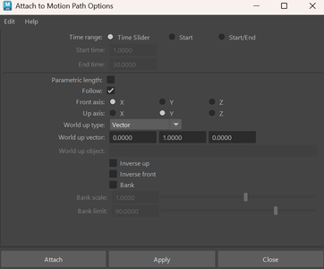

Step 9: Animation, Motion Path
Depending on the number of shots you want to do you can now start to animate the individual shots.
I started by adding the cycles to the shot that I needed to use. The rig I was using had a specific control that was used to create the flight path, so I simply animated that and adjusted the path by editing the Editable Motion Path I explained to you earlier. In other rigs it might be easier to create an actual path and attach your dragon to it.
Attaching the dragon to the Motion Path:
  1. Create a locator (Create - Locator) and rename it
  2. Select the locator and then the control of your dragon you want to attach to the path, then go to Modify - Match Transforms - Match all Transforms to move the locator to the control
  3. Now select the locator first, then the control and go to the Animation Menu, Constrain - Parent, so the locator drives the Control.
  4. At this point create a curve Create - Curve Tools - EP Curve and draw it in an orthographic view into your scene. You can also modify it later by right clicking it and selecting "Control Vertex". Those pink vertices can be moved around.
  5. Now select the locator, then the curve and in the Animation Menu go to Constrain - Motion Paths - Attach to Motion Path. In the option box you can now adjust the rotation of your dragon.

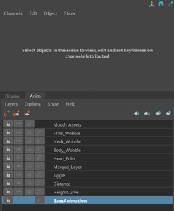

Step 10: Animation, Layers
Adding detail to Animation Layers:
To make the flight cycle unique I added detail to it on so called "Animation Layers". Those are located underneath the channel box and stack animation over each other, add to it over even overwrite it.
I used it a lot to make movements more extreme, like the head or the wings and add detail to the whole motion.
Animation Layers also have the advantage, that you can turn them off, so you can look at the whole animation with or without detail, like jiggles and wind. All of the repetetive detail movements we animated in the previous step, like jiggles, can be added onto Layers.
  1. To create an animation layer to the program, you will need to either select the button on the right in the Animation Layer Tab showing a plane with a plus (create a layer) or the icon with a plane and a sphere (create a layer and add the selected ctrls to it)
  2. This will now create two layers. The base animation with everything you have done so far and a new layer, which you can now animate on top on.
  3. If you select the layer and there is a green button on the right, the control you have selected is included in the layer. If it is not there the animation will still be created on the base layer.
  4. To animate on the top layer you will need to set a key on the selected control first. If you do not key it you will animate on the base layer.
  5. The 0 button on the left sets the control back to the value that the control had without the layer enabled and basically resets it and can be very useful as well.
  6. Once you are consent with your layer you can either keep it to turn it on and off. In my case, I baked a lot of the layers down to the base layer again, to have more control over the Graph Editor. You bake the layers down by shift selecting at least two layers, right clicking and pressing "Merge Layers". I recommend you to choose "Smart Bake" in the option box, so you do not get more keys than necessary.

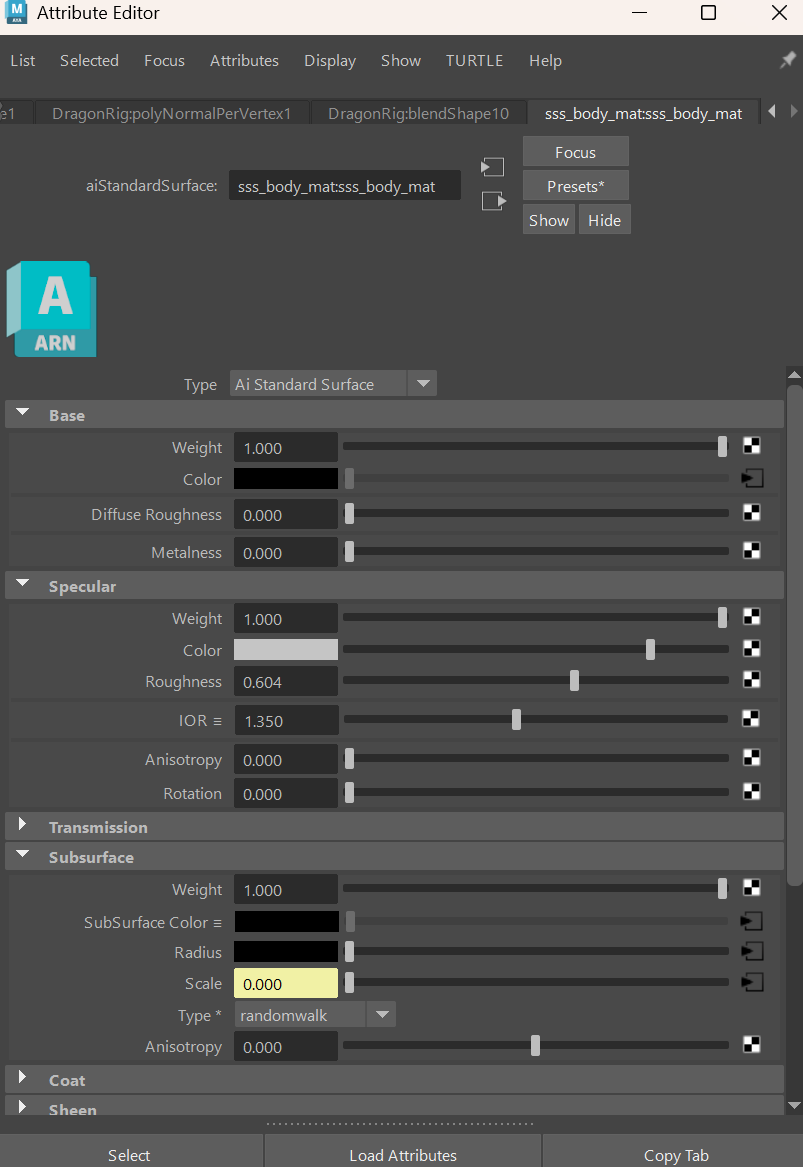

Step 12: Textures
As this article is only supposed to cover the animation of my sequence, Textures, Lighting and Rendering are basically a little bonus that I wanted to add for you guys that wraps up the project.
Textures:
  1. Be sure to use Arnold Materials. You check if your rig has Arnold Materials, by right clicking the geo and going to "Material Attributes" or navigating to the most right tab in the Attribute Editor. Under the Color Tab, you should have an arrow that pulls up the material options when pressed. Here you can check if the material option in the drop down menu has an ai in front (like ai standard surface). If it does not it is not an arnold material.
  2. In this case you can go to Arnold - Shaders - Convert Shaders to Arnold. Here you have to check if all of the textures are still found and might have to link them if not. You could also set up the material completely from scratch. In this case you have the option to adjust the roughness or even add a subsurface to it.
  3. If you have any surfaces that your dragon interacts with, like me in my last shot, it is a good idea to take a look at the so called "ai Shadow Matte" material, which only displays the shadow of an object on a surface without showing the geometry, allowing you to add this on top of your footage. For this step you will need to roughly model the geometry that the dragon interacts with like shown in the second attached picture.
Useful tutorial:
  1. Creating Realistic Materials Using Arnold in Maya
Step 13: Lighting
  1. For lighting the scene I used an HDRI from the website Poly Haven. For this you have to create a Skydome by going to Arnold - Lights - Skydome Light. In the attributes of the skydome light you can now navigate to the hdri you selected and will use the colors from that image in your lighting. If you want to be very fancy you can also create your own HDRI.
  2. Additionally I used directional lights to have more control over my lighting. For this go to Create - Lights - Directional Light.
  3. In my case I used light groups to have a better overview on what light influences what surface and changing up that lighting during compositing. More on that in the tutorial I added down below.

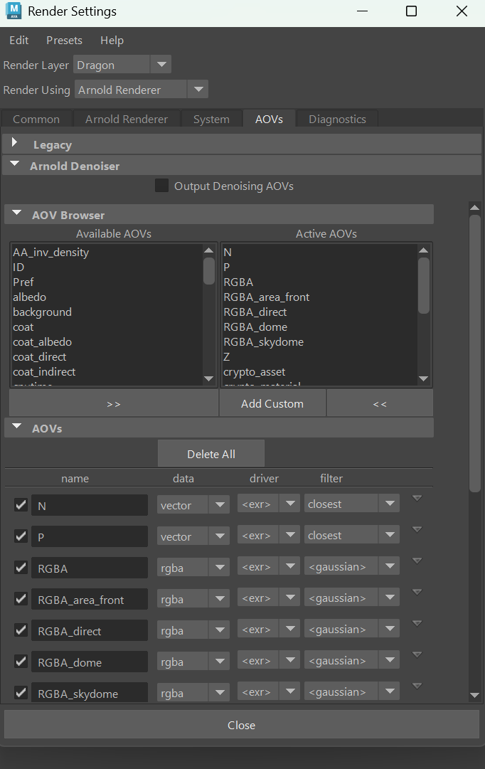

Step 14: Rendering
  1. For rendering I used Render Layers, to have my shadow and dragon split up. This allowed me not only more flexibility in the compositing process but also to have surfaces reflect their color while not being shown in the render.
  2. Furthermore I used AOVs to split up passes for the compositing process and giving me more flexibility on the overall look later on.
  3. Take a look at the third picture and the tutorial I attached down below for more information on it. Be sure to contact me if you have any questions.
