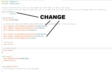

Step 6: Upload the Code
Now that we know the range of motion of the system, we can run the real code to make the eye(s) move
  1. Open single_eye_motion.ino or double_eye_motion.ino, depending on your build
  2. In the ino tab, change the Eye or Eyes declaration to have the correct pins as in your build
  3. Change the values in the set functions to match your lower, upper and centre values from your calibration
From here, you should be able to run the code and watch the magic happen. I would be rather cautious on the first run, just to make sure nothing breaks.
