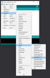

- Open the Arduino IDE and upload the StandardFirmata code from the examples. This will allow the processing code and our GUI to interact with the microcontroller

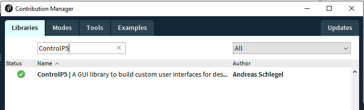

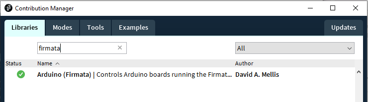

- Inside the Processing, IDE add the libraries "Arduino (Firmata)" and "ControlP5"
- Once you have added the libraries to the IDE, copy and paste the code in the next section to Processing.

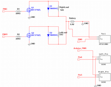

Step 3: Circuit Construction
- Connect both ground busses on the breadboard together with a jumper
- Plug the Arduino nano into the breadboard, bridging the gap in the middle
- Connect the GND pin from the Arduino to the upper ground rail on the breadboard
- Connect the 5V pin to the upper power rail on the breadboard
- Connect the ground lead from each of the servos to the upper ground bus
- Connect the power lead from each of the servos to the upper power bus
- Connect the signal lead from the servos to pins to pins 5, 6, and 9
- Pin 5 is for the right fin servo
- Pin 6 is for the left fin servo
- Pin 9 is for the tail servo
- Place both MOSFETS on the breadboard
- Connect the gate of one MOSFET to pin 3 on the microcontroller and connect the gate of the other microcontroller to pin 11 on the microcontroller. Make sure that the 220 Ohm resistor is between the gate and the microcontroller
- Connect the source pin on both microcontrollers to the ground bus
- Plug both diodes into the breadboard
- Using jumpers, connect the positive end of the diodes to the lower power bus of the breadboard and the negative end of the diode to the drain of one of the most
If you are unfamiliar with how a breadboard works, here is a link that explains how all the holes connect.
https://learn.sparkfun.com/tutorials/how-to-use-a-...
When we connect to put the breadboard into the frame, we will connect the motor and battery leads. Instructions on doing so will be in that step.
