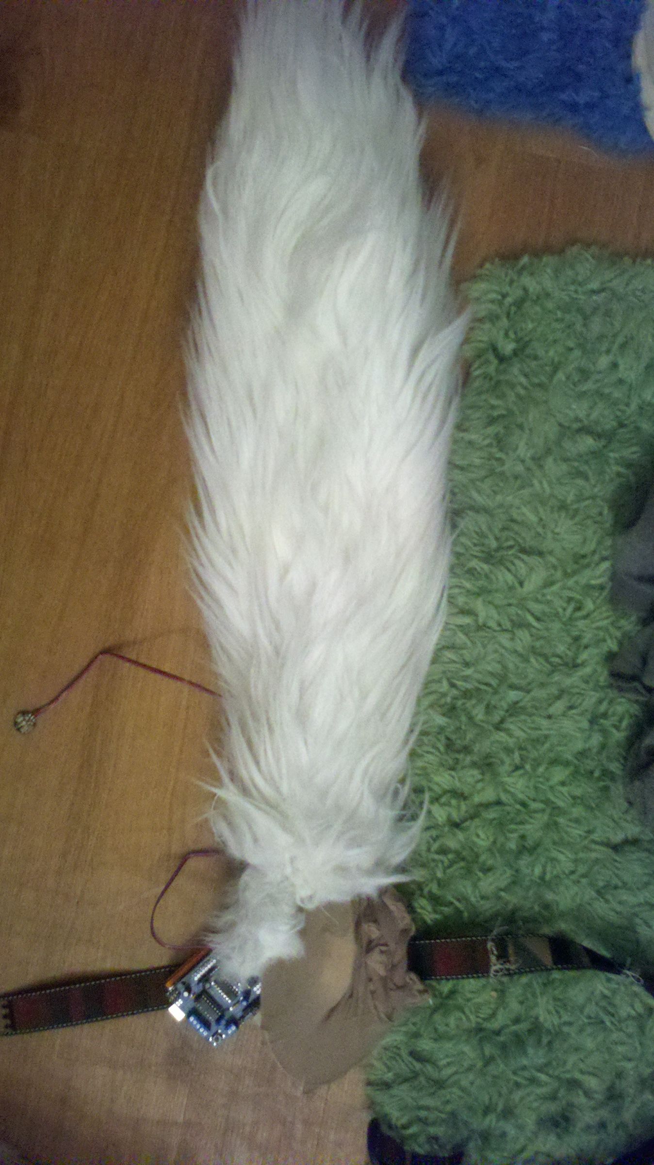

-With your fur laying fuzzy side down on the floor/ work space sketch out a hoodie shape ( "hoodie" as in the hood part of a jacket) using your tailor chalk/pencil. With your measuring tool measure from the top of your skull to the bottom of your base, this will be the length of your hoodie. Next measure from the top of the skull to the bottom of the lower jaw, this will be the length of the opening of your hoodie shape. Also measure from the edge of your skull to the back of your base/ mannequin, this will be the width of your hoodie shape.
-Repeat this same process except this time have the hoodie sketch facing the opposite direction of the other sketch. They should be mirror images of each other. Using your knife cut out both shapes from your fur.
-Next trace two triangles on the back of your fur these will be your ears, it's up to you what you want to use for "Cartilage" ( The support system for your ear: can be made with foam, cardboard, etc.) Cut out the same two triangle shapes from your cartilage material except this time make the triangles and inch or 1/2 an inch smaller than your fur triangles, this is so you can wrap the fur around the cartilage to give a more authentic look.
Note:DON'T USE SCISSORS to cut your fur, you'll just end up trimming the fur, it'll get everywhere and it wont look as natural.
-Next Fold the pieces so the fur sides are touching and pin them together along the outer edge, Then just sew! Don't forget to sew on your ears as well.
-Pull your hood over your skull and base and glue it down.
