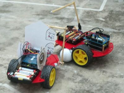

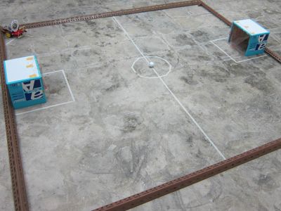

Annikken wanted to get in the mood for the World Cup and the best way is to ask our interns to create robot teams. Using Annikken Andee and their mobile devices , it was easy to control their dribbling and scoring!
We gave them each the same tools so as to be fair to all, Magician Chassis - DG007 was fully equipped with all they need to start making the base of their soccer robot. We also provided them with Annikken Andee, companion board, Arduino proto shield, Annikken Andee Starter Kit and a pair of chopsticks for their extended arm.
They had to learn Arduino from our Annikken Andee library. Using the lessons on our website they are able to create functional interfaces to take control of their soccer robots. With lessons on how to create customise slider and buttons, all they need was an idea on how to grab the ball and dribble toward the goal.
