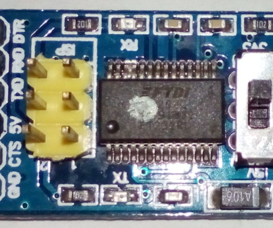

Here is counter I built as a working prototype for a company I once worked for. This was the second version.
For the first one I used buttons taken from the front of an older “AT” computer case along with LED’s from the same case.
These shields generally have 3 spare DIO’s and 5 spare AIO’s but check your shield as they are not all the same and some have more spares If they are serial based/ i2c etc.
This one has plated through holes on the upper and lower edges that I wired to a distribution block. Soldered mine but recommend using angled pin headers.
