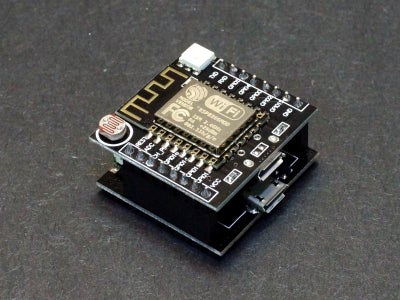

Step 2: Get the Hardware, Second Variant
2) The second board I tried, because it was in the drawer, it's the black board, and I got it from here:
https://cleste.ro/placa-dezvoltare-nodemcu-esp-12f...
Again, don't mind the name NODEMCU ESP-12F, it's also found as Witty Cloud ESP8266, the hardware is the same as WEMOS board, but split into two boards. I pictured both boards together. The ESP8266 it's on the bottom of the picture and has 3.3V regulator to supply the ESP8266 board and not fry it with 5V. On top of the picture it's the shield board, that basically has the CH340 and the circuitry (two transistors) to pull the GPIO0 and RST as needed to program it. It has also two press buttons that basically do the same thing as the transistors, one connected to RST pin, the other to GPIO0. Ofcorse, as in the instructable projects linked above, one can try the bare ESP8266 boards, with the help of a programmer, but it will need a 3.3V regulator soldered somehow on a pcb. The shield of the NODEMCU ESP-12F it is a programmer that can be used with other boards that you might have. So if you get this board, you get a programmer too.
The pinout of the Witty Cloud is a bit different than Wemos D1 mini, as you can see in the pictures, but they both can be programmed with the same compiled code.
